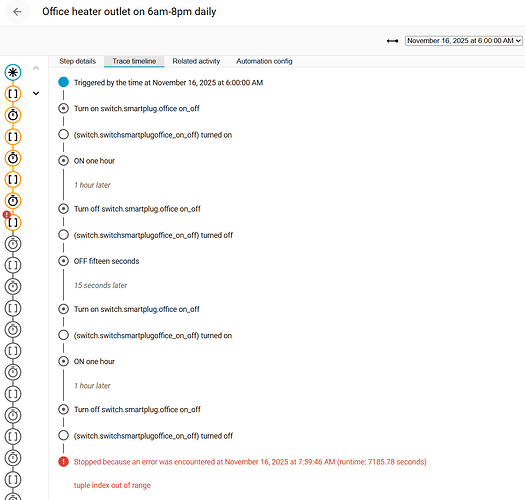

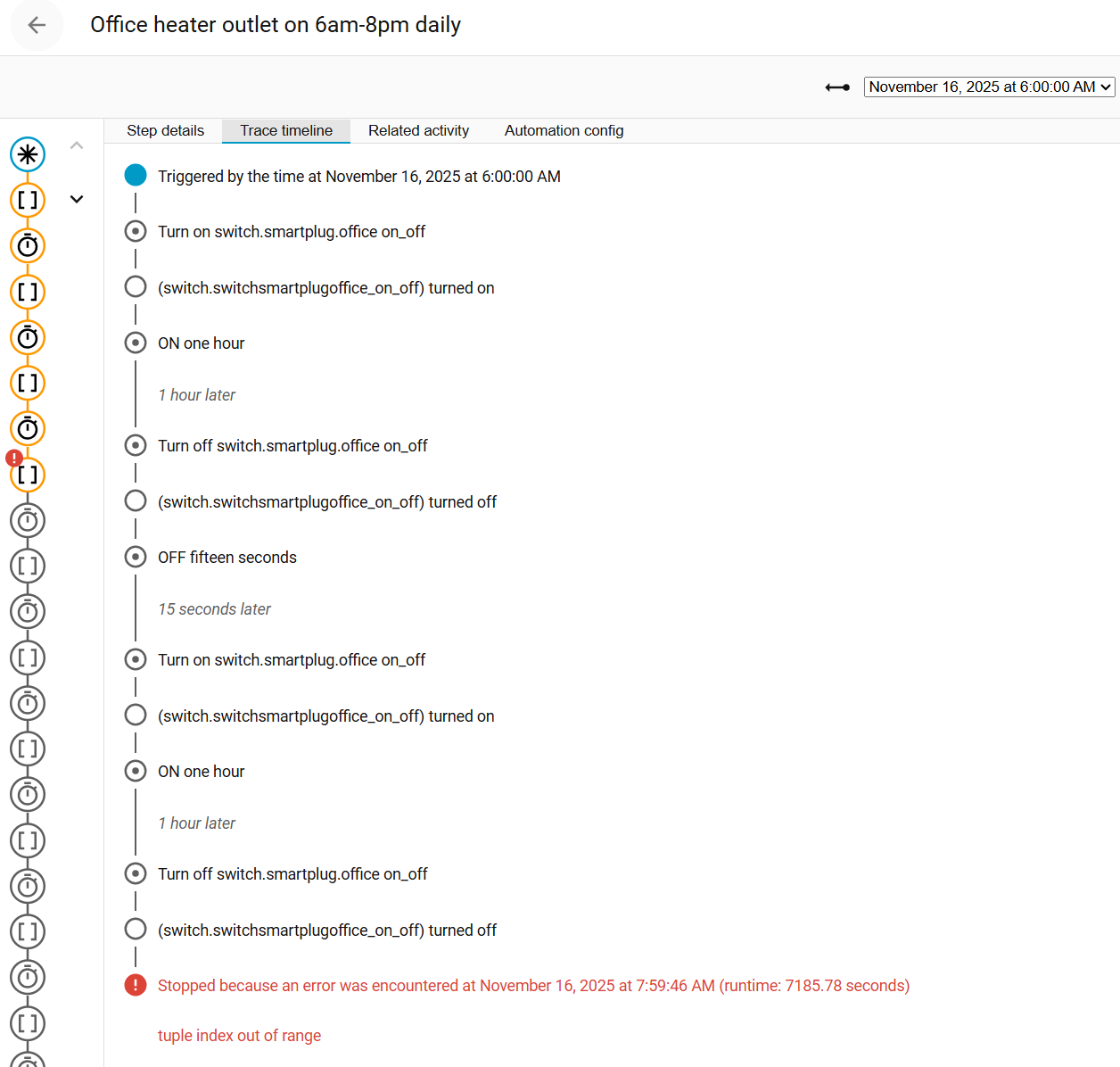

Hello all,
I have a rather simple automation that worked flawlessly for months and has suddenly stopped working.
There is a small electric space heater in my office that I use on cold days. Sometimes I leave the office and forget to turn it off, heating an empty room for hours and wasting energy. I created an automation that would control the receptacle the heater is plugged into via a Sonoff S31 Lite zigbee smartplug. The smartplug cycles on and off during my typical office hours, ensuring the maximum amount of time I’m heating an empty room is less than one hour.
When the smartplug is first switched on at 6 am, the space heater turns on in a standby mode, with the heating element off. If I want heat, I then manually turn on the heating element. If not, the heater stays in a standby mode with the heating element off. After a one hour delay, the smartplug switches off, turning the heater completely off. After a 15 second delay, the smartplug turns back on, and the heater turns on in standby mode again. This cycle repeats fourteen times until the smartplug turns off and stays off at my end of my day.
The automation now only makes it completely through two cycles before it stops. The error message is “Stopped because an error was encountered at November 16, 2025 at 7:59:46 AM (runtime: 7185.78 seconds)
tuple index out of range”. As I said in the beginning, this automation has worked perfectly for months, until a few days ago.
Any ideas would be appreciated.
cheers,
Karl

`alias: Office heater outlet on 6am-8pm daily
description: ""
mode: restart
triggers:
  - at: "06:00:00"
    trigger: time
conditions: []
actions:
  - type: turn_on
    device_id: 847adb3ba0159234273cb4d64e890287
    entity_id: switch.switchsmartplugoffice_on_off
    domain: switch
  - delay:
      hours: 0
      minutes: 59
      seconds: 45
      milliseconds: 0
    alias: ON one hour
  - type: turn_off
    domain: switch
  - alias: OFF fifteen seconds
    delay:
      hours: 0
      minutes: 0
      seconds: 15
      milliseconds: 0
  - type: turn_on
    domain: switch
  - delay:
      hours: 0
      minutes: 59
      seconds: 45
      milliseconds: 0
    alias: ON one hour
  - type: turn_off
    domain: switch
    delay:
      hours: 0
      minutes: 0
      seconds: 15
      milliseconds: 0
  - type: turn_on
    domain: switch
  - delay:
      hours: 0
      minutes: 59
      seconds: 45
      milliseconds: 0
    alias: ON one hour
  - type: turn_off
    domain: switch
    delay:
      hours: 0
      minutes: 0
      seconds: 15
      milliseconds: 0
  - type: turn_on
    domain: switch
  - delay:
      hours: 0
      minutes: 59
      seconds: 45
      milliseconds: 0
    alias: ON one hour
  - type: turn_off
    domain: switch
    delay:
      hours: 0
      minutes: 0
      seconds: 15
      milliseconds: 0
  - type: turn_on
    domain: switch
  - delay:
      hours: 0
      minutes: 59
      seconds: 45
      milliseconds: 0
    alias: ON one hour
  - type: turn_off
    domain: switch
    delay:
      hours: 0
      minutes: 0
      seconds: 15
      milliseconds: 0
  - type: turn_on
    domain: switch
  - delay:
      hours: 0
      minutes: 59
      seconds: 45
      milliseconds: 0
    alias: ON one hour
  - type: turn_off
    domain: switch
    delay:
      hours: 0
      minutes: 0
      seconds: 15
      milliseconds: 0
  - type: turn_on
    domain: switch
  - delay:
      hours: 0
      minutes: 59
      seconds: 45
      milliseconds: 0
    alias: ON one hour
  - type: turn_off
    domain: switch
    delay:
      hours: 0
      minutes: 0
      seconds: 15
      milliseconds: 0
  - type: turn_on
    domain: switch
  - delay:
      hours: 0
      minutes: 59
      seconds: 45
      milliseconds: 0
    alias: ON one hour
  - type: turn_off
    domain: switch
    delay:
      hours: 0
      minutes: 0
      seconds: 15
      milliseconds: 0
  - type: turn_on
    domain: switch
  - delay:
      hours: 0
      minutes: 59
      seconds: 45
      milliseconds: 0
    alias: ON one hour
  - type: turn_off
    domain: switch
    delay:
      hours: 0
      minutes: 0
      seconds: 15
      milliseconds: 0
  - type: turn_on
    domain: switch
  - delay:
      hours: 0
      minutes: 59
      seconds: 45
      milliseconds: 0
    alias: ON one hour
  - type: turn_off
    domain: switch
    delay:
      hours: 0
      minutes: 0
      seconds: 15
      milliseconds: 0
  - type: turn_on
    domain: switch
  - delay:
      hours: 0
      minutes: 59
      seconds: 45
      milliseconds: 0
    alias: ON one hour
  - type: turn_off
    domain: switch
    delay:
      hours: 0
      minutes: 0
      seconds: 15
      milliseconds: 0
  - type: turn_on
    domain: switch
  - delay:
      hours: 0
      minutes: 59
      seconds: 45
      milliseconds: 0
    alias: ON one hour
  - type: turn_off
    domain: switch
    delay:
      hours: 0
      minutes: 0
      seconds: 15
      milliseconds: 0
  - type: turn_on
    domain: switch
  - delay:
      hours: 0
      minutes: 59
      seconds: 45
      milliseconds: 0
    alias: ON one hour
  - type: turn_off
    domain: switch
    delay:
      hours: 0
      minutes: 0
      seconds: 15
      milliseconds: 0
  - type: turn_on
    domain: switch
  - delay:
      hours: 0
      minutes: 59
      seconds: 45
      milliseconds: 0
    alias: ON one hour
  - type: turn_off
    domain: switch
  - trigger: time
    at: "18:01:00"
conditions: []
actions:
  - choose:
       - conditions:
          - condition: trigger
        sequence:
          - action: switch.turn_off
              entity_id: switch.smartplug_office_on_off
            delay: '00:00:15'
          - action: switch.turn_on
          - action: timer.start
              duration: "0:59:45"
              entity_id: timer.smartplug_office_heater
      - conditions:
        sequence:
          - action: timer.cancel
Is there a thermostat on the heater itself?
Or does it simply heat continuously from 06:00 to 18:00 (except for those periodic 15 second intervals when your automation turns it off)?
No thermostat. Simply on/off with my switching
What kind of office space requires continuous heating for 12 hours?
Is it a drafty, uninsulated space or is the heater woefully undersized for the volume to be heated?
OP explained that turning the switch on places the heater into an idle/standby mode then they make it heat as needed… it doesn’t actually run for most of the 12 hours.
How exactly?
If turning on the switch puts the heater in idle/standby, what makes the heater actually heat. The OP said the heater has no built-in thermostat.
I assumed “my switching” meant the automation. Is it something else?
I assumed they press a button… :upside_down_face: … but it is unclear.
Plenty of newer-but-not-smart devices have digital on/off controls that would reset to idle/off by a power cycle. I’ve got a couple area fans that I use a similar smart-plug based method to reset them to standby when they are left running and their area is empty.
So the heater is operated manually and this automation just puts the heater in and out of standby mode? :thinking: :man_shrugging:
Yes Taras. By cycling power to the heater the automation simply puts the heater in a standby mode every hour on the hour during the day.
This automation only powers the heater (in standby mode) during the hours I typically use the office. It also assures if I turn on the heating element and happen to leave the area, the heater will not continue to run all day. It will only run until the next even hour (e.g. 8am, 9am, 10am, etc.). The slight inconvenience is I need to manually turn on the heating element when I’m cold. A positive side effect happens every hour when the heater enters standby, it puts out a single “beep” to remind me of the time, like an old grandfather clock.
There is a crude thermostat on the space heater, but it does a poor job controlling room temperature, so I just run the heater periodically to take the chill off my immediate work area. I’m sure there are more elegant solutions to this problem, but this works for me. Thanks.
Karl
