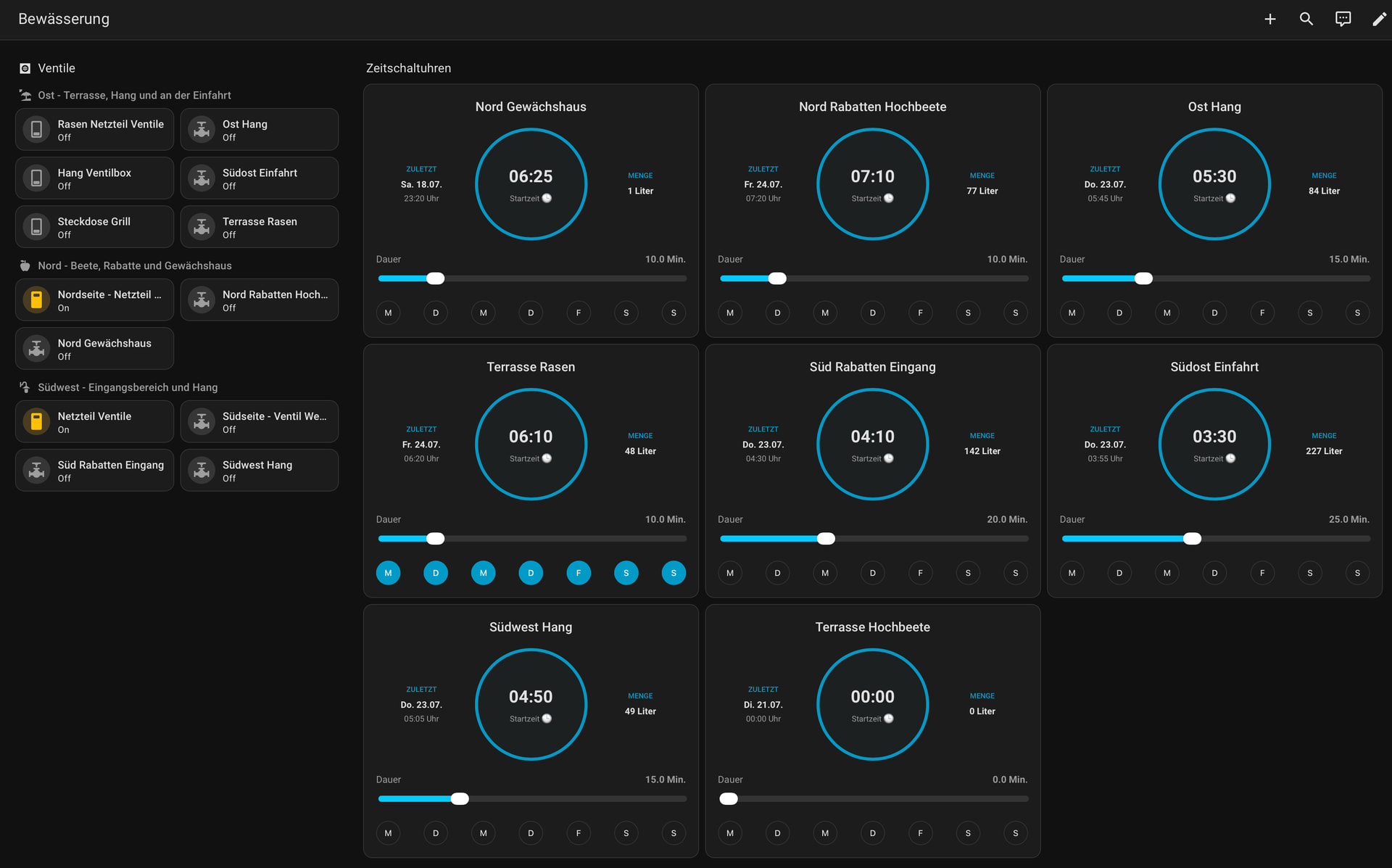

Timer Card widget for controlling a home irrigation system via automation, helpers and KNX entities
Timer function and widget for Home Assistant dashboard for controlling a garden home irrigation system via KNX. Also including reading and storing of individual water usage via integration with Grünbeck system. This was developed together with Google Gemini.
Zeitschaltuhr-Funktion und Widget für Home Asisstant Dashboard zur Steuerung und Kontrolle eines Gartenbewässerungssystem mit mehreren Ventilen über KNX. Die eigentliche Ansteuerung erfolgt im Hintergrund über Automationen und entsprechende KNX-Entities. Zusätzlich wird der Wasserverbrauch pro Ventil über die Integration mit einer Enthärtungsanlage von Grünbeck (softliQ.D) gelesen und gespeichert. Die Skripte und diese Beschreibung hier wurden zusammen mit Google Gemini entwickelt.
Here is the GitHub link: GitHub - starauschek/watering-timer-card: Timer function and widget for Home Assistant dashboard for controlling a garden home irrigation system via KNX. Also including reading and storing of individual water usage via integration with Grünbeck system. · GitHub
:glowing_star: Features
  • Sleek Dashboard Card: Quick overview of remaining runtimes, selected weekdays, start times, and water consumption.
  • Clean Package Structure: All helpers (input_number, input_datetime, input_text, timer) and automations per irrigation zone are neatly grouped into a single YAML file.
  • Latency Tolerance for Water Meters: Features an automatic delay post-shutoff to allow delayed cloud updates (e.g., from Grünbeck systems) to capture accurate water usage.
  • Flexible Valve Control: Supports main power supplies/transformers as well as single- or dual-switch irrigation zones (e.g., KNX relays or smart plugs).

:artist_palette: 3. Dashboard Card Configuration
Add a new Manual Card to your Home Assistant dashboard and paste the following YAML:
type: custom:watering-timer-card
title: Beispiel Kreis
time_helper: input_datetime.beispiel_kreis_zeit
duration_helper: input_number.beispiel_kreis_dauer
days_helper: input_text.beispiel_kreis_w
valve_switch: switch.DEIN_VENTIL_SCHALTER
last_run_helper: input_datetime.beispiel_kreis_last_run
timer_helper: timer.beispiel_kreis_restlaufzeit
last_water_helper: input_number.beispiel_kreis_verbrauch
