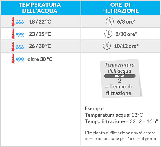

Are the durations you’ve chosen special, or is it just an attempt at proportionality?
I ask because there is a template function that can map a value proportionally, so if that is the goal the automation could be greatly simplified.
I’ve got a table from some websites on how much to run the pump based on water temperature to avoid algae and issues.
I think I can use a proporitional :slight_smile:

actions:
  - variables:
      temperature: '{{ states(''sensor.sonoff_10001c5cd2_temperature'')|float }}'
      min_temp: 20
      max_temp: 28
      min_duration_minutes: 120
      max_duration_minutes: 600
      duration: >-
        {{ remap(temperature, min_temp, max_temp, min_duration_minutes,
        max_duration_minutes,  edges='clamp')|round(1) }}
      sunrise : '{{ states(''sensor.sun_next_rising'') }}'
      price_start: '{{ today_at("19:00") }}'
      calculated_start: '{{ sunrise|as_datetime|as_local - timedelta(minutes=duration) }}'
      start: '{{ max(calculated_start, price_start)|as_datetime|as_local}}'
      end: '{{ start|as_datetime|as_local + timedelta(minutes=duration) }}'
  - action: calendar.create_event
      entity_id: calendar.local
      summary: Pump On
      start_date_time: '{{ start|as_datetime|as_local }}'
      end_date_time: '{{ end|as_datetime|as_local }}'
  - metadata: {}
      entity_id: notify.piscinalog
      message: >-
        Test Calendar | temperature {{temperature}}°C | duration {{duration}}
        min | start {{start|as_datetime|as_local}} | end
        {{end|as_datetime|as_local}} |DEBUG| sunset
        {{sunset|as_datetime|as_local}} | calculated_start
        {{calculated_start|as_datetime|as_local}} | price_start
        {{price_start|as_datetime|as_local}} | max 1  {{ max(calculated_start,
        price_start)|as_datetime|as_local }}
      title: Piscina Pump Schedule Set
    action: notify.send_message
mode: single
I’ve tested it with different values for temperature (forced) and the result is always good :slight_smile:
