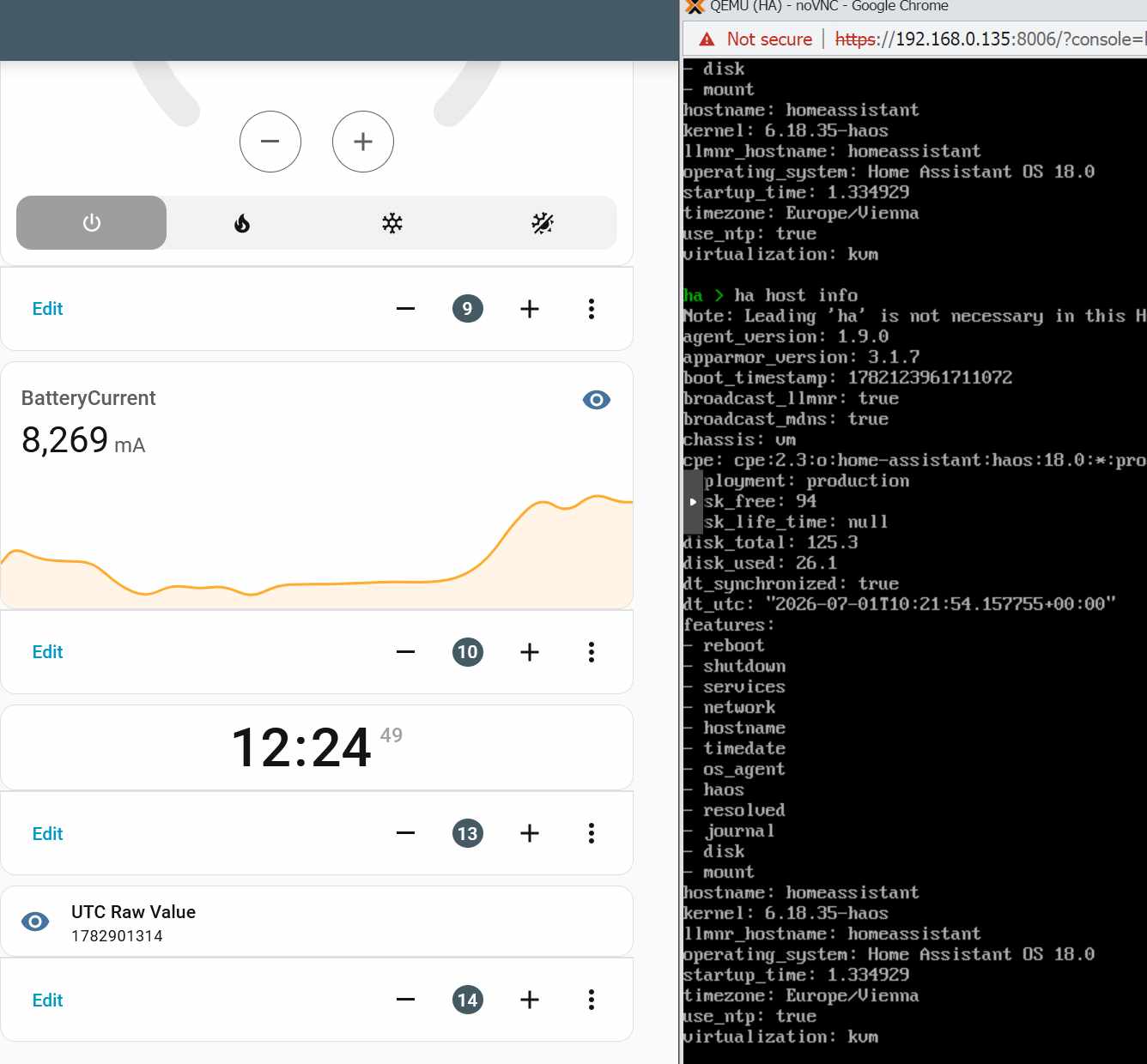

Timestamp off by 170 seconds
12:24:49 vs 10:21:54 (+2)
12:24:49 is the time the screenshot was taken according to my two other PC's synced by NTP.
But don't waste your time. If it occurs just here and is not a general issue i can easily live with it. It looked weird to me (and still does) so i wanted to report.

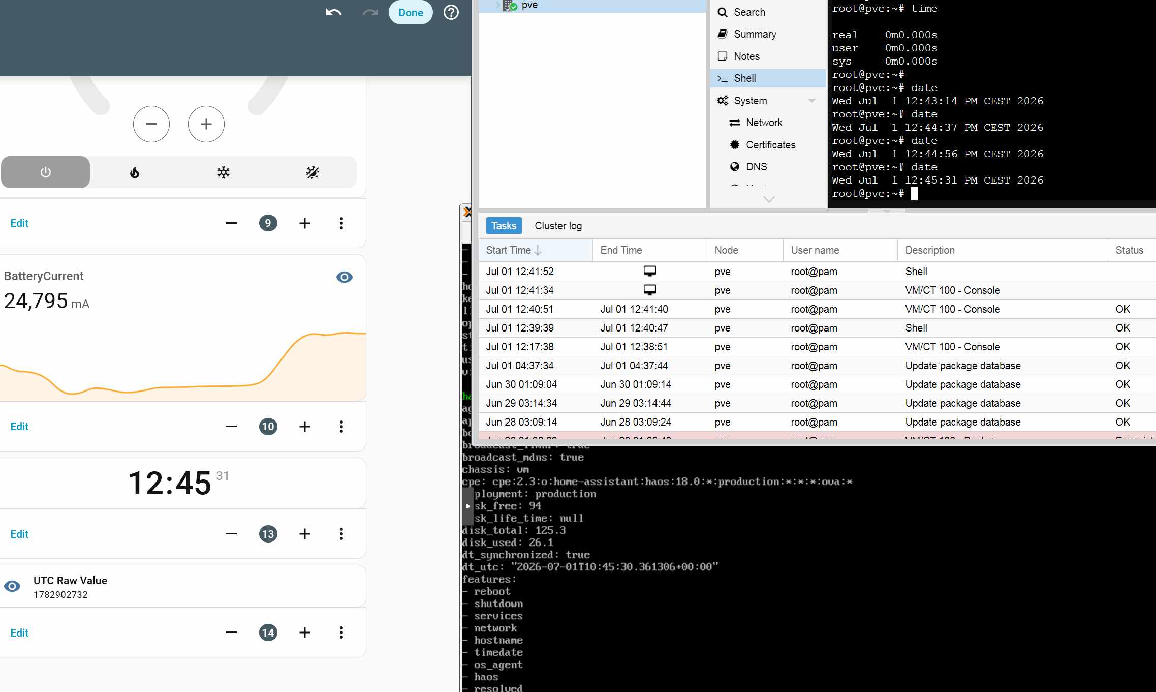

Proxmox, right?
What's the proxmox server time vs the HA time?
that 1/2 second is due to my slow fingers :wink:
Hmm, but that 1782902732 seem to be correct now matching 12:45:31 ?????
So is maybe something wrong with my Proxmox installation ?
The timestamp you show is also 12:45 :wink:
YES i have just noticed. Seems it is NO LONGER shifted but WHY ?
Was opening Proxmox making the difference ?
THANK YOU SO MUCH for helping. My BMS is now 170 seconds ahead :slight_smile: and i can drop the workaround !

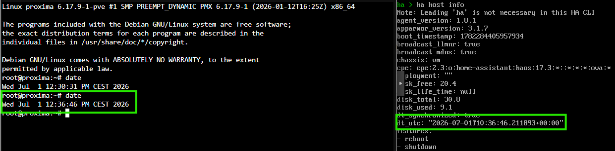

No clue. Maybe the HA VM is frozen for 170 sec at some point?
HA itself relies on the VM clock, I assume, so if that one gets desynchonized at some point...
Yes but how could/did the time displayed not rely on the same tic-value ? Seems there are two of them :wink: One used for time-card, another one ....
Now they are corresponding again. Still a small miracle :wink:
