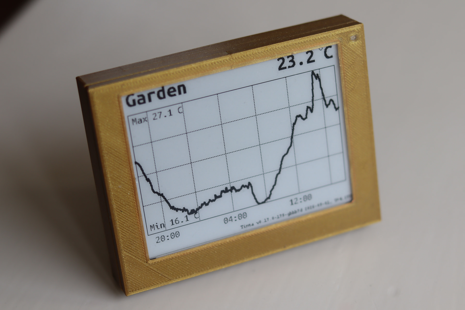

I would like to show you a small device I have been building. It is called Tinta, it hangs on a wall without any cable, and it displays whatever you want from Home Assistant on e-paper.
The way it works: at configurable times Tinta wakes up, connects to the local WiFi, asks Home Assistant for the data you selected, “prints” it onto the e-paper, and then switches itself off completely. E-paper keeps showing the content while the device is off. There is no deep sleep involved — a hardware RTC and a MOSFET cut the supply, so between two updates the microcontroller draws almost nothing and the RTC alarm (or push buttons or NFC) switches it back on.

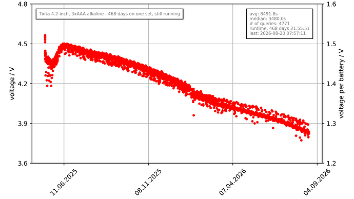

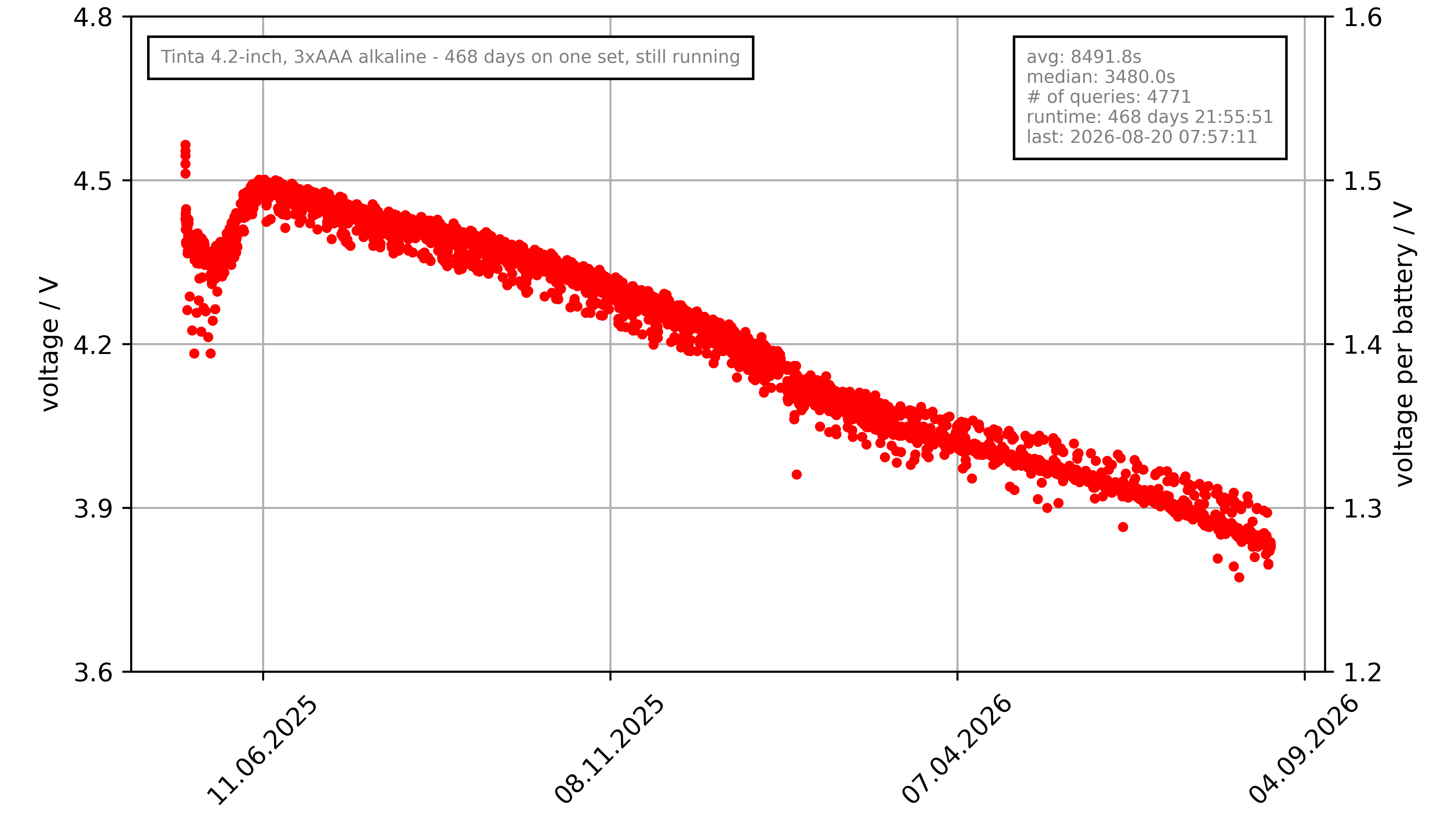

This is a real measurement, not a datasheet estimate. One 4.2-inch unit has been running unattended on a single set of three AAA alkaline cells:
468 days, 4772 display updates, waking roughly once per hour — still going.

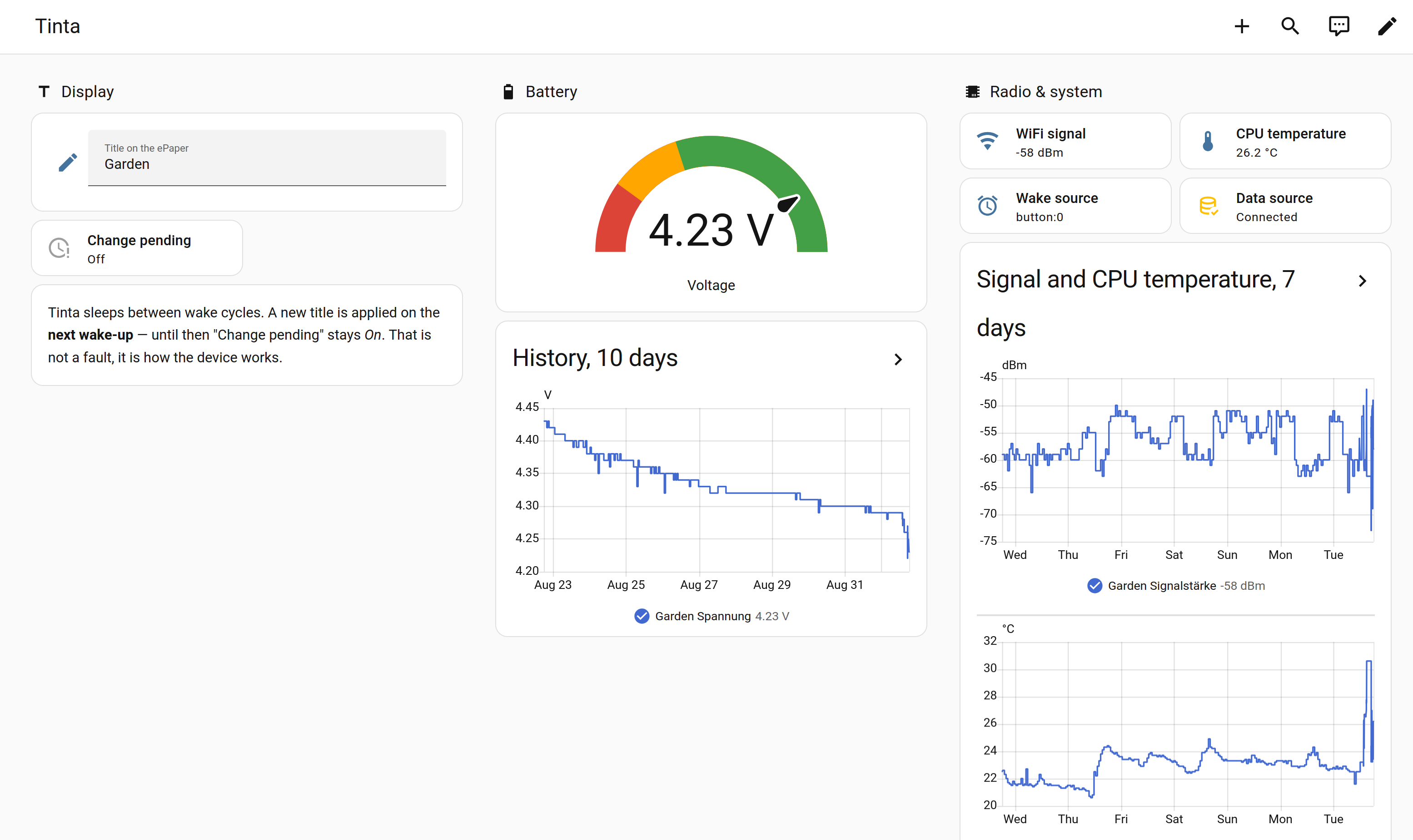

Tinta announces itself over MQTT discovery. After the first wake there is a device in HA with its entities — battery voltage, WiFi signal, CPU temperature, wake source, and a few more you can switch on or off in the web interface.
The other direction is used to configure Tinta. Discovery can declare writable components, so the display title is a text entity in HA: you type into it, the retained command waits on the broker, and Tinta applies it on its next wake. A binary_sensor shows “change pending” until that happens. No helper entities and no automation needed. Refresh interval and data source will follow through the same mechanism. This can easily be extended to other variables. Additionally, Tinta can also be setup via wifi acting as access point.
For the content itself Tinta reads the HA REST API — the current value of any entity, and its recorder history for a graph. Which entity and which time window are set in the web interface, so nothing has to be recompiled.

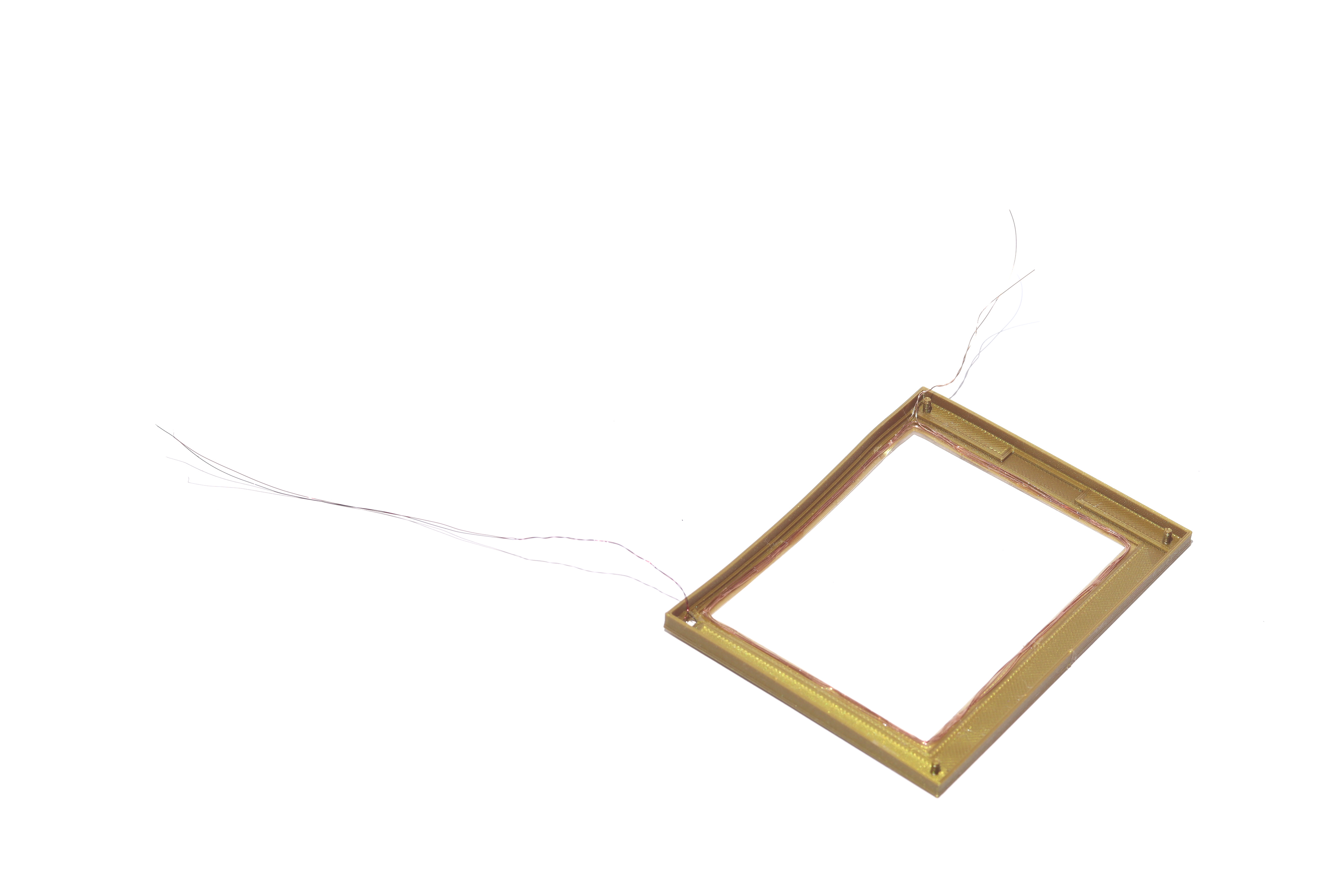

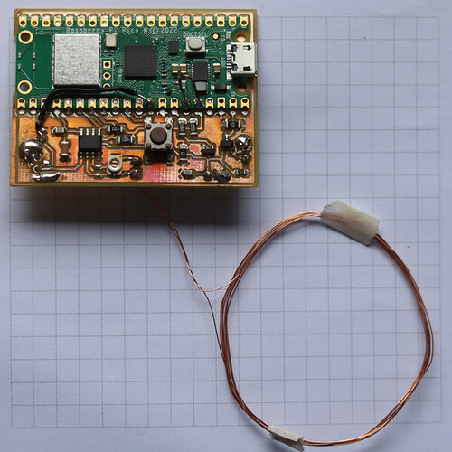

There is also an NFC chip with a coil in the enclosure. Hold a phone against the display and it wakes — the chip is powered entirely by the phone’s field, so the tap itself costs no battery at all, exactly the same wake concept (and circuitry) as the RTC alarm. Beyond waking, the tap can write: a short text note or a small hand-drawn sketch from the phone, straight onto the e-paper. A digital replacement for the sticky note on the door frame. This can be extended for home assistant commands - I am open for ideas!

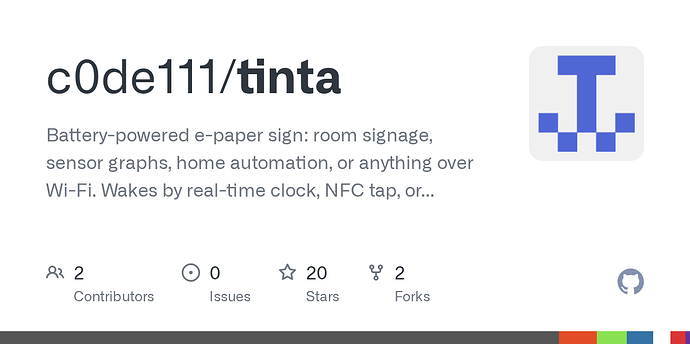

Everything is open source — firmware, KiCad project, and the enclosure:
You do have to solder the custom PCB if you build one yourself.

A small addition to the NFC part above, for anyone interested in the circuit details. You can find schematic, coil, and the measurements behind it at
That wake path got an honorable mention in Hackaday’s Green-Powered Challenge in May: Congratulations To The Green Powered Challenge Winners! | Hackaday From the article: “We love the idea of surreptitious NFC-powered data insertion while the microcontroller is still sleeping.”
