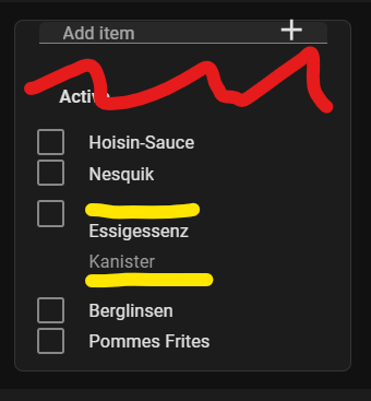

Hi, I have this card:
How can I get rid of
a) the red marked space with header ā€œActiveā€?
b) the yellow marked spaces?
Here is my code:
type: todo-list
entity: todo.zuhause
theme: Mushroom Square
hide_completed: true
grid_options:
  columns: 6
card_mod:
  style:
    ha-textfield:
        .mdc-text-field {
          margin-top: -15px;
          margin-bottom: 0px;
          height: 15px !important;
        .mdc-text-field__input {
          color: white !important;
      ha-card.type-todo-list div.header {
        display: none;
      ha-check-list-item.editRow.completed {
        display: none;
      :host {
        --mdc-checkbox-ripple-size: 16px;
      ha-check-list-item {
        min-height: 20px !important;
      ha-card {
        --mdc-typography-subtitle1-font-size: 12px;
      ha-icon-button.addButton {
        margin-top: -20px !important;
Adding this works for me but it feels a bit brutal to play with h2 headers so use with caution.
div.header: |
h2 {
display: none;
Didn’t work here. But I don’t know where/how to exactly add. Could you please post your complete card_mod code?

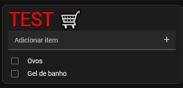

For the first question:
      type: todo-list
      title: 'TEST šŸ›’'
      entity: todo.google_keep_compras_supermercado
      card_mod:
        style:
          ha-textfield:
              .mdc-text-field {
                margin-top: -28px;
                margin-bottom: 5px;
                height: 50px !important;
            .card-header {
              color: red !important;
              font-size: 50px !important;
              display: none;
              display: none;
            :host {
              --mdc-checkbox-ripple-size: 33px;
              color: red;
              font-size: 50px;
              min-height: 28px !important;
            ha-card {
              --mdc-typography-subtitle1-font-size: 17px;
              font-size: 50px;
            ha-icon-button.reorderButton,
              margin-top: -35px !important;
            .divider {
              display: none;
Add the next section (as shown above) acconding to your likings:
            .card-header {
You must make sure the text advancing is like avove. You get:
:wink:

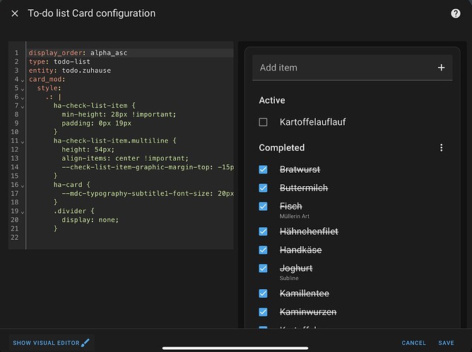

Hereā€˜s another CSS example for To-do lists
display_order: alpha_asc
type: todo-list
card_mod:
  style:
        padding: 0px 19px
      ha-check-list-item.multiline {
        height: 54px;
        align-items: center !important;
        --check-list-item-graphic-margin-top: -15px !important;
      ha-card {
        --mdc-typography-subtitle1-font-size: 20px;
      .divider {
        display: none;

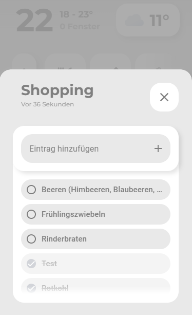

Hello shadow-DOM, my old friend… I’ve come to style with you again. I also gave this a shot and made some small adjustments like scroll-overflow for the list and hiding the header. I tried to round off those checkboxes to make everything look a bit nicer (see screenshot), but I haven’t been able to target them properly yet. It’s been ages since I last wrestled with card mod, has anyone here managed to style these checkboxes before?
display_order: none
type: todo-list
entity: todo.mealie_wocheneinkauf
hide_completed: false
card_mod:
  style:
      ha-card .addRow {
        border-radius: var(--border-radius);
        box-shadow: var(--card-shadow) !important;
        padding-top: 16px !important;
        padding-bottom: 16px !important;
      .addBox {
        background-color: var(--card-item-background);
        mask-image: linear-gradient(to top, var(--card-item-background) 0%, black 8px);
        transition: all 0.4s ease-in-out;
        padding: 0px 16px 0px 0px;
        font-weight: 500;
        font-size: 15px;
        margin: 8px 16px 0px 16px;
        --mdc-list-item-graphic-margin: 0px !important;
      ha-check-list-item.completed {
        opacity: 0.5;
      ha-sortable {
        max-height: 240px !important;
        display: block;
        overflow: auto;
        scrollbar-width: none;
        mask-image: linear-gradient(to top, transparent 0%, black 16px, black calc(100% - 16px), transparent 100%);
      ha-check-list-item * {
        overflow: hidden;
        white-space: nowrap;
        text-overflow: ellipsis !important;
        height: 54px;
      ha-card {
        padding-bottom: 16px;
        --mdc-typography-subtitle1-font-size: 16px;
        --mdc-text-field-fill-color: transparent;
      .header, .divider {
        display: none !important;

hi, is there any way to set icon depding on the entry for each line? kind of what is doing the bring app, auto recognition of the elements…
This card looks very nice. In my opinion, it gets significantly more out of the standard list. I copied and pasted the code. Unfortunately, it doesn’t look as nice for me. Card_mod is installed. But for example, the boxes remain square instead of round for me. What am I doing wrong? These individual colored sections are also very nice. Is this done via themes?
Hi :slight_smile: The code contains some CSS variables which are defined in my theme. You probably don’t have those variables, so you need to replace them with your own variables or just some actual values, like colors.
Here’s the updated code with the specific values filled in:

Great, that helped a lot. I was now able to adjust the color code with my code for the Material You Theme using ā€˜var(–card-background-color)’.
Only the checkboxes are unfortunately still not round…

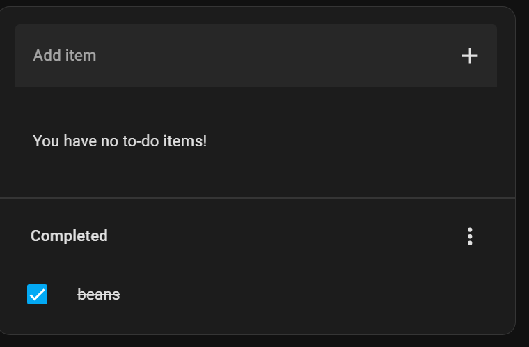

Is it possible to rename the ā€œActiveā€ and ā€œCompletedā€ headers while still hiding the 3 dot icon? I currently have them hidden with a section of code from Freelancer here but I can’t seem to figure out how to rename the actual ā€œactiveā€ text.
While I like the look of the text being hidden, for my wall mount tablet dashboard it would be nice to be able to see a edited ā€œactiveā€ and ā€œcompletedā€ section
I think you may need to replace mwc-checkbox with ha-checkbox since 2025.5 release of home assistant.
