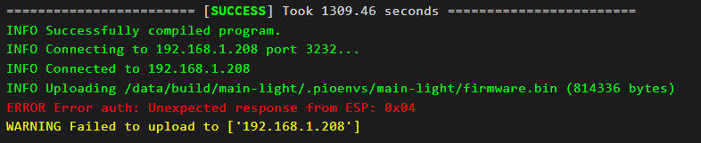

it worked to convert to esphome, it connects and show esphome web, but fails to upload new skech via home asistant esphome bulder:(
I’ve found a workaround the auth error - use an older version of ESPHome: https://community.home-assistant.io/t/unable-to-upload-images-on-shelly-pm-mini-gen3-unexpected-response-from-esp-0x04/957846
After that you can use ESPHome builder in HA without issues.
