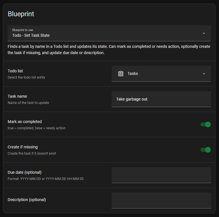

Todo - Set Task Completed / Needs Action (with optional due date & description update)
This blueprint allows you to manage Todo list items in Home Assistant. It was mainly written to allow for automations to set certain tasks as done or not done.
Features:
  • Mark tasks as completed or needing action
  • Create task automatically if missing
  • Set due date (date or datetime)
  • Update task description
Works with:
  • Any Home Assistant todo.* integration (Local To-do, Google Tasks, etc.)
Use cases:
  • Automations that complete recurring tasks
  • Voice assistants marking tasks done
  • Smart reminders with deadlines
Blueprint:

User Interface:
I can think of a bunch of uses for this. Thank you for sharing!
Just a quick update: it turns out the todo.update_item action already supports using the task name directly (not just the UID).
I had assumed a UID was required when I created this, which led me to build this blueprint. But that’s not actually the case.
So for most use cases, this can be done more simply with the native action todo.update_item.
