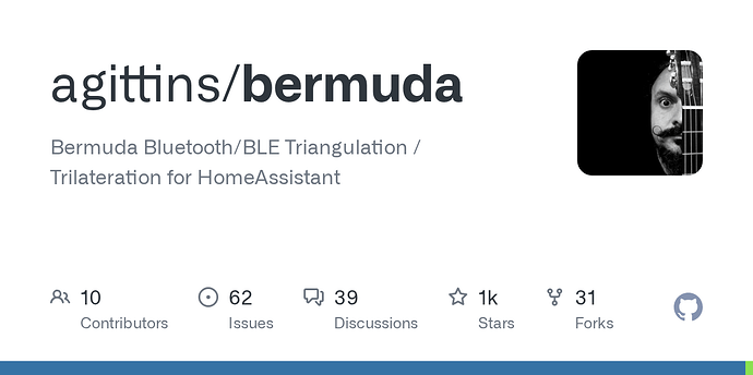

If they have a phone, Bermuda will identify it without it having to be registered anywhere else in HA.
Nott unless it is set to act as a ibeacon, and for me that worked with varying success. Or do you know a way to identify a phone without HA acting as iBeacon?

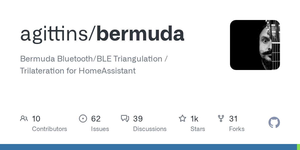

There’s a guide to getting the IRK here:
I won’t be asking my guests to pair their phone any time soon :grinning:
Would be nice if the code to get the IRK is added to esphome at some point.
