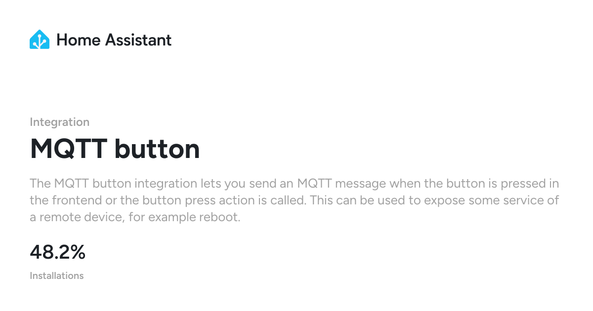

Because payload_press does not support templates. You can use the command template to generate the payload to send
