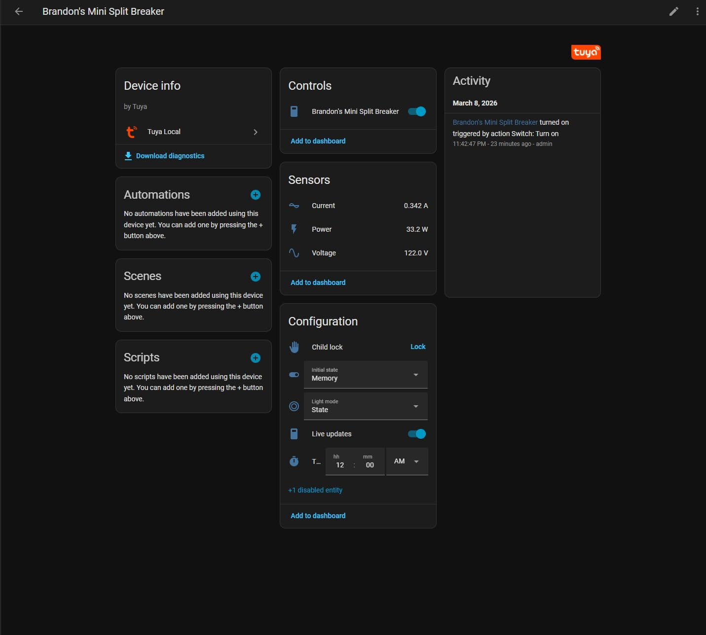

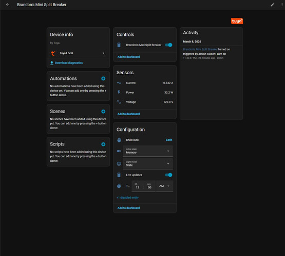

So i originally purchased the Aeliussine wifi version and paired it to home assistant was amazed it paired easily caught the wifi through the roof no problem and integrated into home assistant via tuya local integration using the taffware_1p63_breaker device profile. Below are the exposed entities:
Number one wasnt stoked about having to use tuya for anything power related :sweat_smile: but it was okay, the reason for my return however is because it polls at 40/second intervals which is too slow for power monitoring and power related automation i may or may not setup in the future so i decided to go zigbee version

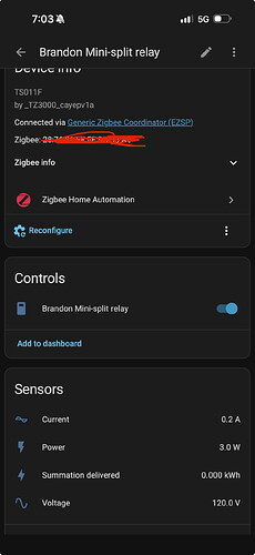

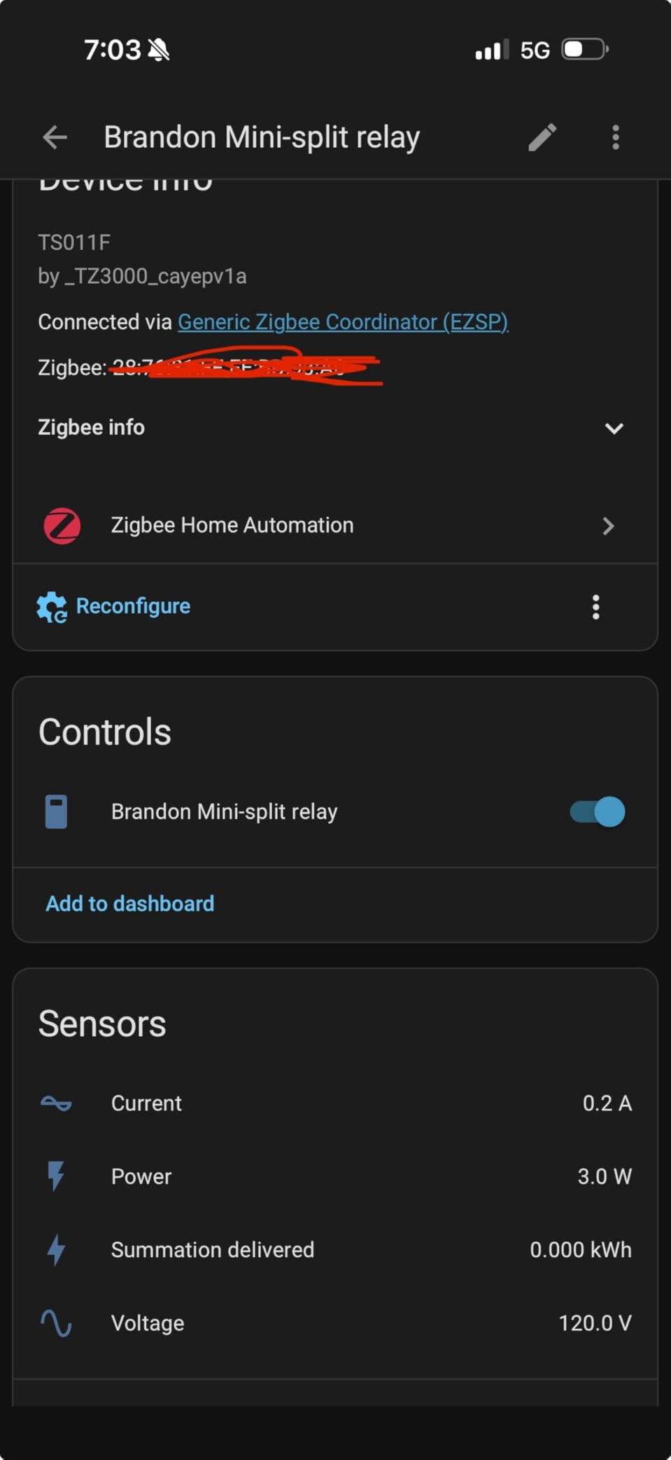

The polling time was much better as low as 1 second (not sure how polling is handled for zigbee stuff tho) but never seen it over 15seconds. and at first it originally exposed the same set of sensors via zha:

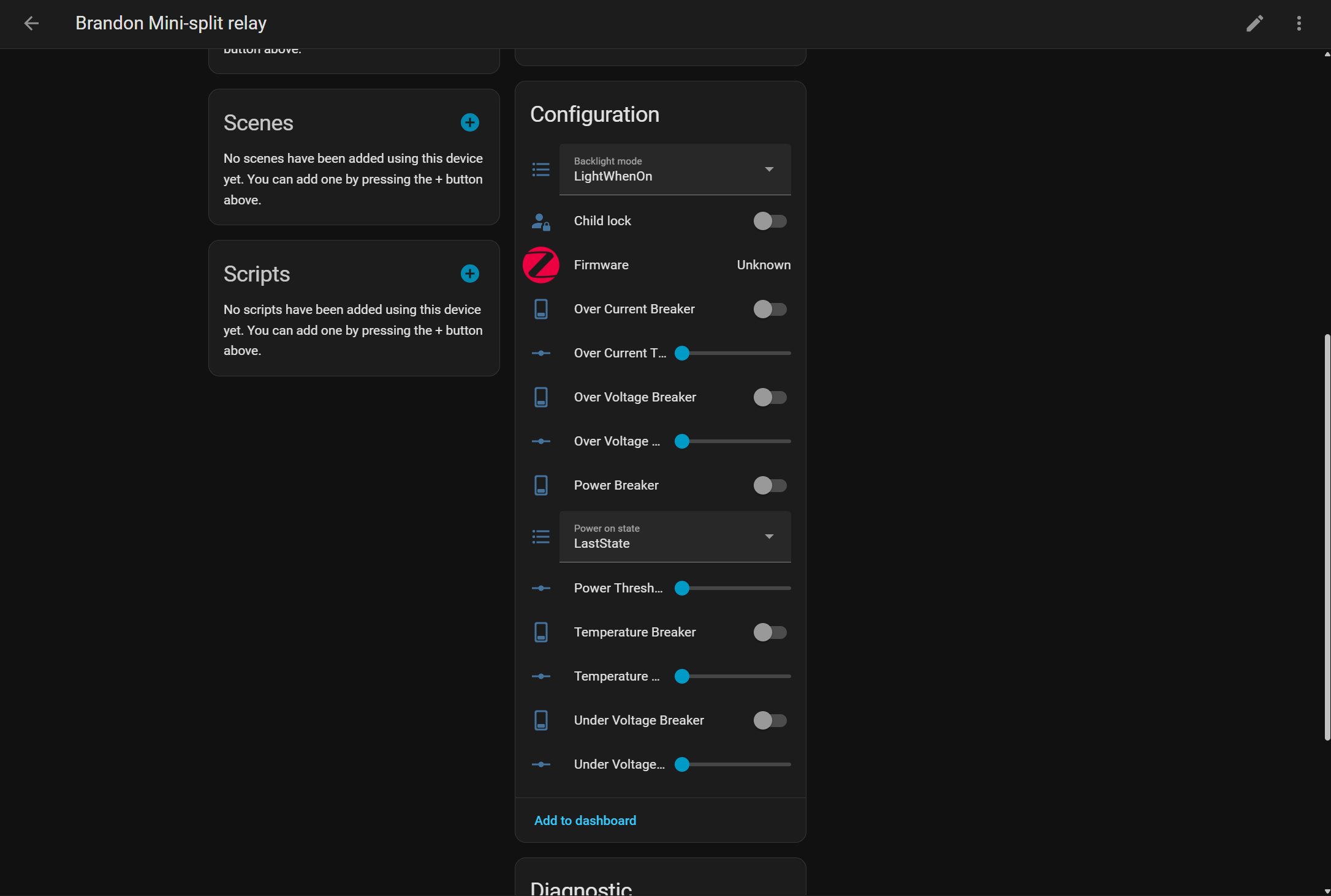

And now i got more sensors exposed
