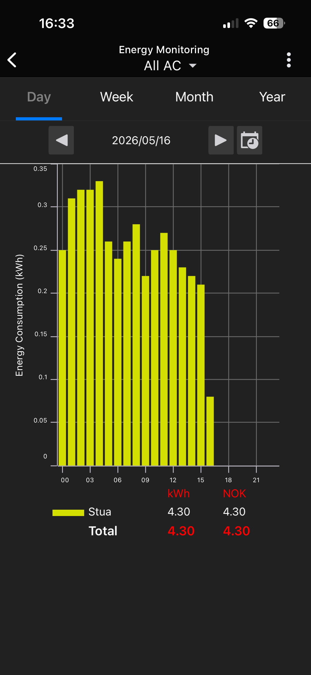

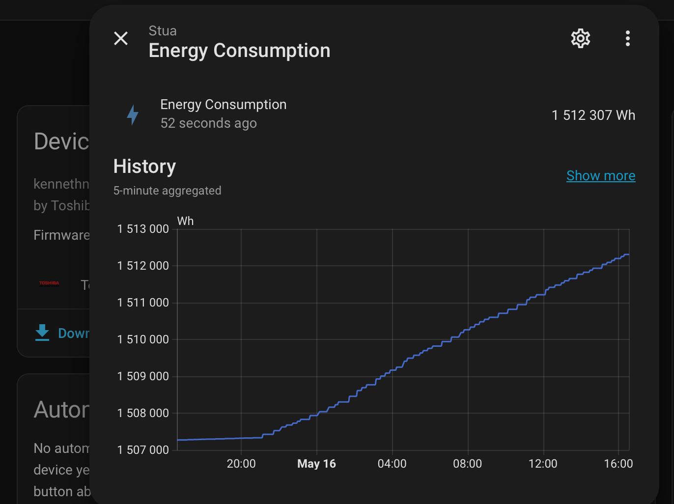

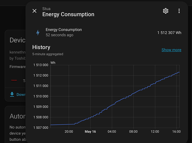

@vmvelev , this is where I´m seeing the deviation with the app vs integration
Mobile app vs HA setup for review.
Hmm, it looks good to me to be honest?
Your app is reporting 4.30 kWh for the 16th of May. Home assistant shows that on 00.00 on the 16th of May, the consumption is 1 508 000 Wh, which is 1508 kWh. At 16.00 on the 16th of May, I see a consumption of ~1512000 Wh, which is 1512 kWh. The difference is around 4kWh which seems accurate.
Do you see it another way?
I just thought of your point - do you need this to reset every day and start from 0 for each of the ACs you have?
@vmvelev , you are maybe on to something here.

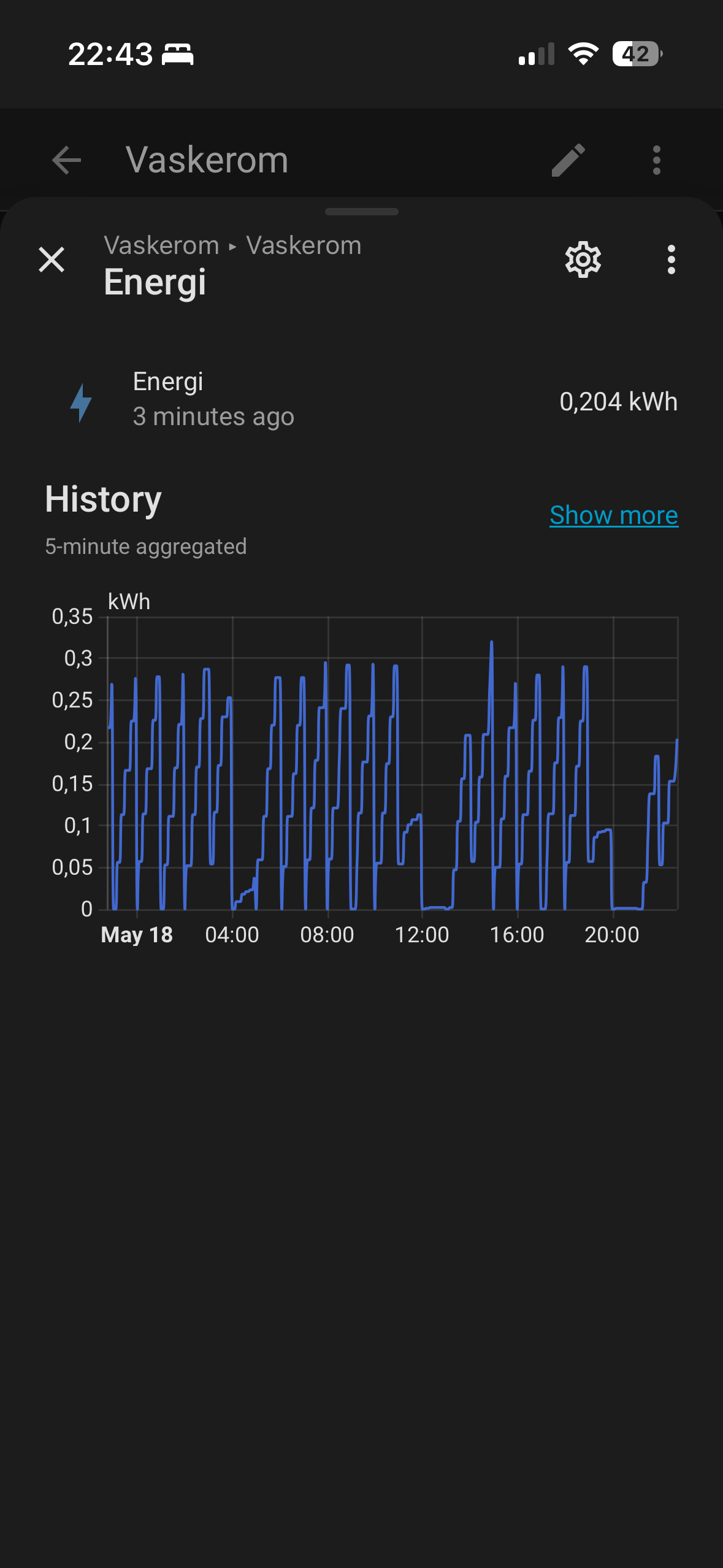

Now it acts as a counter, but as a power consumption I was more expecting per hour. Adding a Adax heater image for reference.
This way it becomes a energy consumption resource in the energy dashboard.
I can create a helper of course, but if possible I think you see the idea? With energy prices shifting per hour it would be nice to adjust high demand power units to be controlled

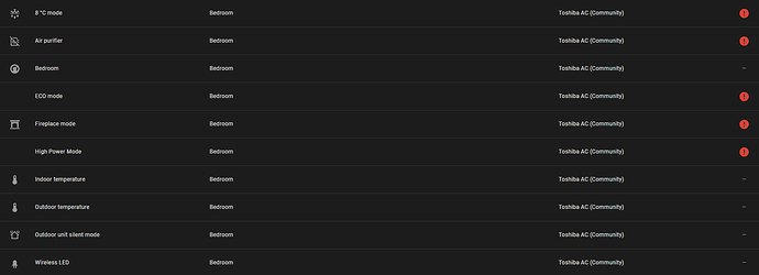

@vmvelev thank you for maintaining this fork, I really appreciate you for that. Quick question on some of the modes that do seem to be included, but are showing as unavailable - I do believe my units support for instance both ECO mode as well as High Power Mode, but in HA these entities report as unavailable - is there a way to enable them?
And out of curiosity, have you made any investigation into enabling the ability to use auto turn off timer via HA?
Thank you in advance… best regards from Czechia :slight_smile:
My bad, did a bit of looking around and figured those entities are mode dependent - the unit needs to be turned on or set in a specific mode for those entities to function.
