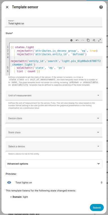

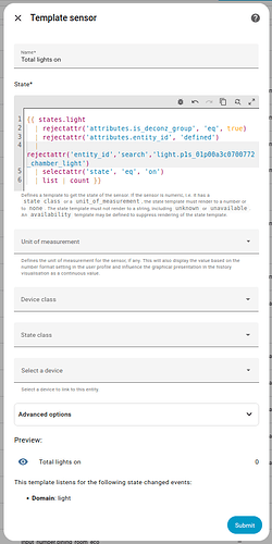

Thank you, I’ll take a look at that in the future, but tbh it scares me a lot the idea of having to rewrite what’s already working and I can potentially bork.
If you’re running a recent release of Home Assistant, you should have already received Repair notices showing how to convert your Template entities.
You have until June to convert them. It would be prudent to start converting them well before the deadline.
Template > Sensor. Then just paste in the template (only the the bits between, and including {{ ... }}) into the State box.
