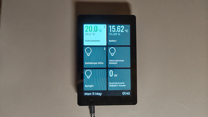

I just created a blueprint to setup an WT32-SC01 PLUS touch panel, that has the OXRS firmware flashed on it to act as a touch dashboard for home assistant.
Currently there are switches, lamps (including RGB and CC), sensors and thermostats implemented.
It's still work in progress, but helps me a lot:

Here a photo:
there are up to five pages currently supported.
