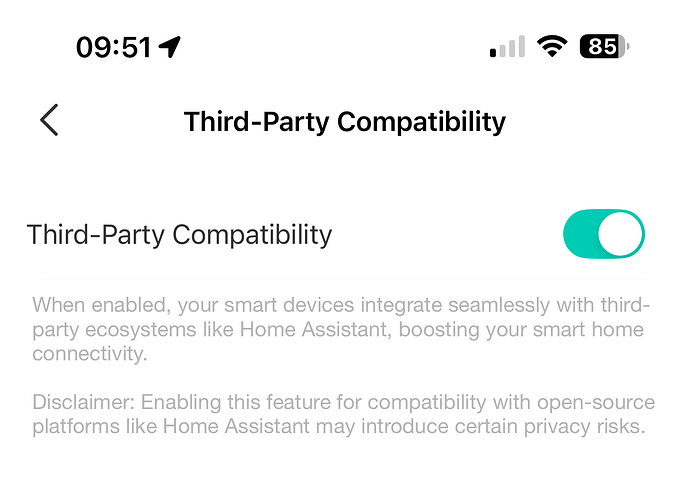

We have some HS300s and KP303s, 5 in total. All of them lost communication due to an auth issue after firmware upgrades. Our HS103s don’t have any firmware updates and never disconnected.
My fix steps:
1 - Log in to the TP-Link Cloud webpage and change my password
2 - Sign back in to the Kasa app after it forced me to sign out from the password change
3 - In the Kasa app, navigate to ‘Me > Settings’ and enable ‘Third-Party Compatibility’
The Third-Party Compatibility option specifically mentions integrating “seamlessly with third-party ecosystems like Home Assistant” (see the screenshot below). From there, I didn’t even have to reauthenticate the strips. They all started coming back on their own.
I also don’t know that the password reset option was necessary, but it was a step I took.

I’ve got the KP303 power strip.
What worked for me was using the Kasa app to set the following setting to on: Me->Settings->Third-Party Compatibility.

Also have had this issue recurring for quite some time.
For me the fix was similar to some of the responses above.
Once you get the failure to authenticate, doing the following has worked for me.
Reboot HA
Once you can access the TPLink integration to reconfigure, attempt login and fail.
Go to the Kasa app and toggle Third-Party Compatibility Off, count to 10, toggle Third-Party Compatibility back to On.
Go back to HA and try to authenticate and it works.
YMMV......
