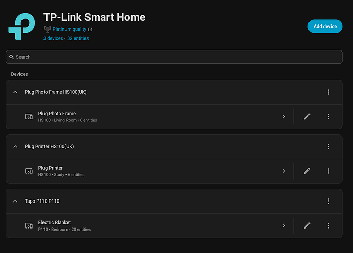

I had an issue with just one of my Tapo P110 plugs. It connected to the phone app, but failed to connect in the HA Tapo integration. I had two of these plugs, the other connected to the Tapo integration just fine. Third party compatibility is on.
In a moment of inspiration I thought about adding it in the HA TP-Link Smart Home integration, as I have a couple of older plugs (HS100), which use that. It succeeded and all the entities available.
So hope this might help someone in the same situation, if it won’t connect to the TP-Link Tapo integration, try the TP-Link Smart Home integration
PS I already had the Kasa app on my phone, which I think might be needed.
