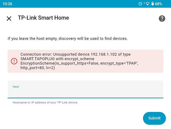

This morning I was notified of a firmware update (1.4.0) to my tp100 plugs. Updated and everything is working except HA. The plugs are not connecting. Reloaded the integration no change. I then removed one plug and planned to re-add it. On re-adding If I leave host blank nothing is found. If I enter the IP address of the plug I get this message…
Any thoughts? I have other plugs on this firmware that are working fine.

Do any of these apply?
I clicked the issues search link in the Official HA Integration page…
Thank you sir - you are a star! My apologies for not reading the Official integrations pages completely enough. Turns out that my problem was the ‘sharing password between devices’ issue noted in the document. For anyone else who might land up here this is what I did…
