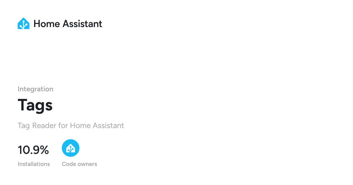

How about an NFC tag on your charge lead that you can scan with your phone?
You can use that (or whatever method you choose) to automate switching tariffs on a utility meter (me / everything else). This will split the energy into seperate sensors.

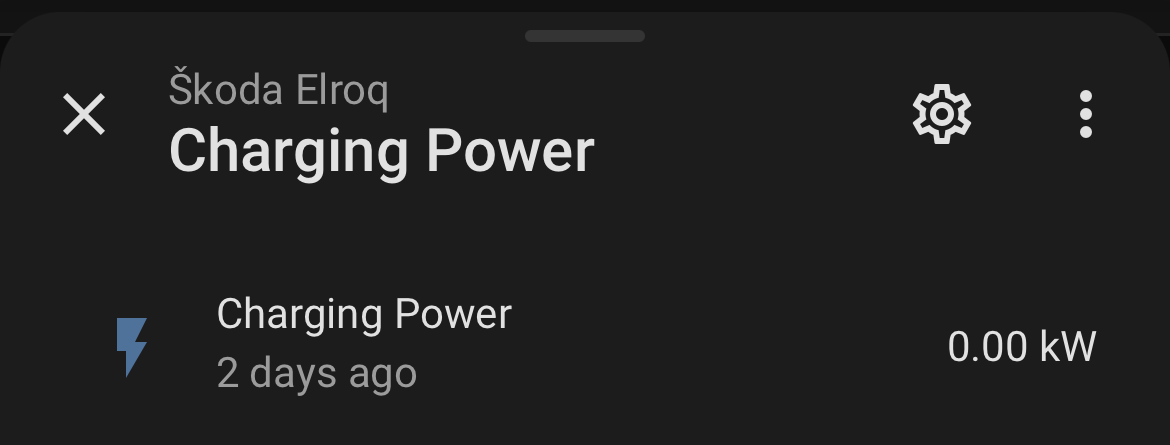

You can’t integrate you EV into home assistant?
For my own EV i can, and as such determine whether my car is home and charging.
If so I can use it’s power sensor to obtain it’s consumption :thinking:
