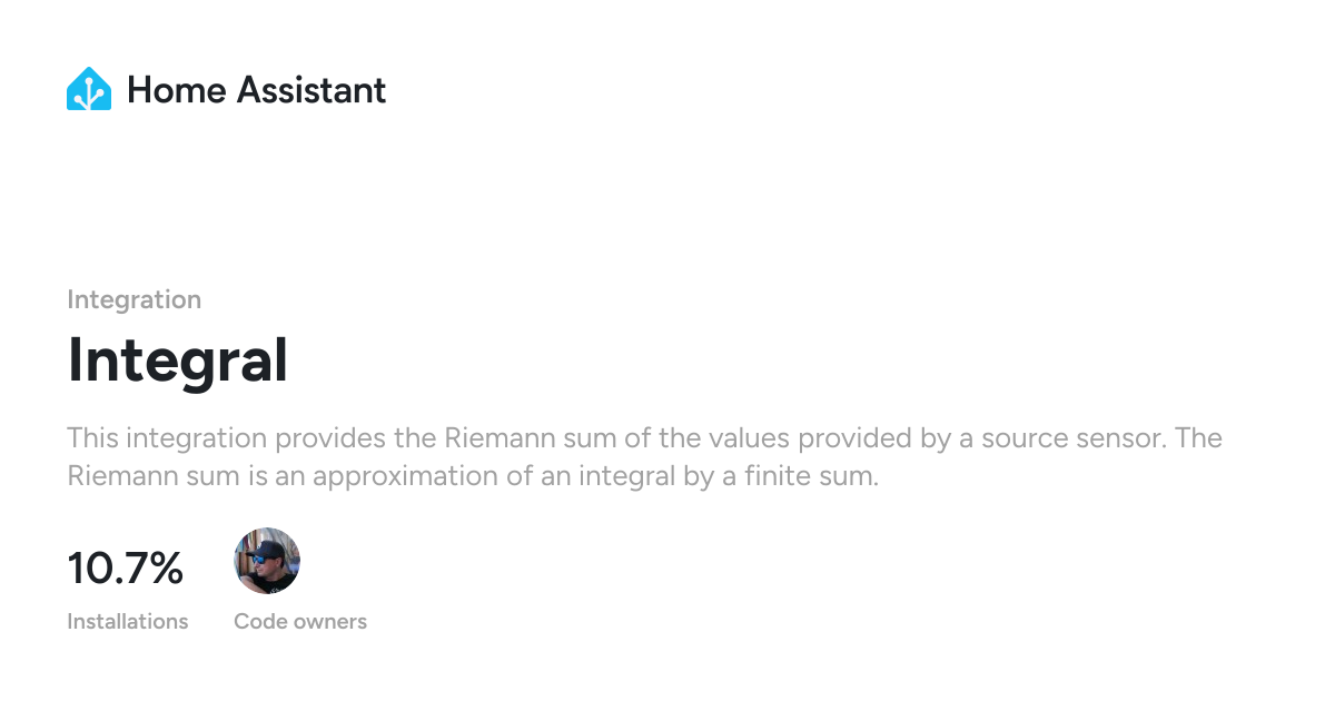

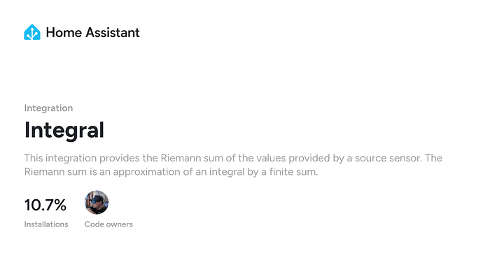

One thing you need is a sensor that simply returns the L/h or L/min value - either 0 when off or the known value when on: 2L/h. Summing the value over time is what integral sensors do. You can create a helper in the helper section. Make sure to use Left Riemann sum as the method or you’ll get weird values.
It will create the total use over time. If you want use per year, month, day, etc. you can use utility meters.
The approach also works if the L/h value is not constant, e.g. if it uses the number of valves that are open or a percentage value to collect the total flow at that instant.
Ps. Though it really isn’t hard once you know how: if you want to do something similar for energy then there is an integration that makes this easier, unfortunately it only does Watts to kWh and not L/min to L although the principle is exactly the same.
