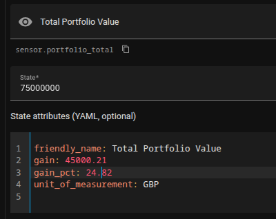

Also from the python script you get one more sensor called:
sensor.portfolio_total
it has the following attributes:
(No, those are not real values :smile: )
