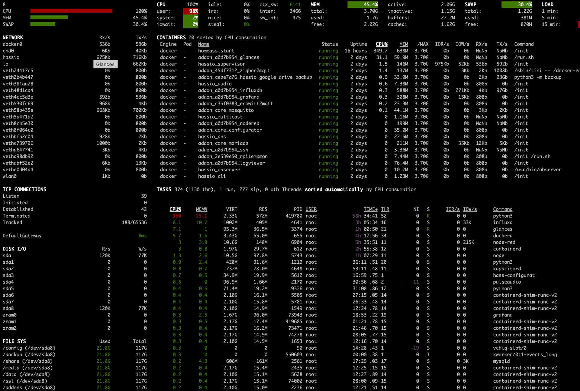

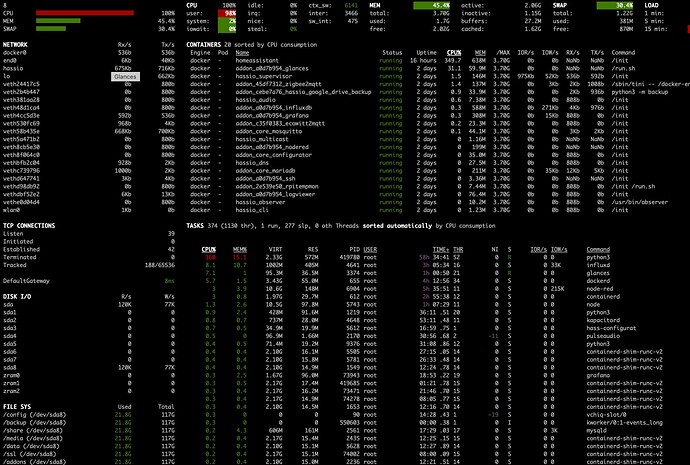

Now HA is running without restart for 16 hours, but CPU is 100% from 15 hours ago.
Here is a screenshot from Glances where is clear that is python3 inside HA container who is consuming the CPU.
After some investigations, I’m pretty sure the responsible is Meteoclimatic integration, a native integration in Homeassistant…at least in my installation.
Seems something related to SSL handshake.
The following thread is always present as current thread in home-assistant.log.fault
