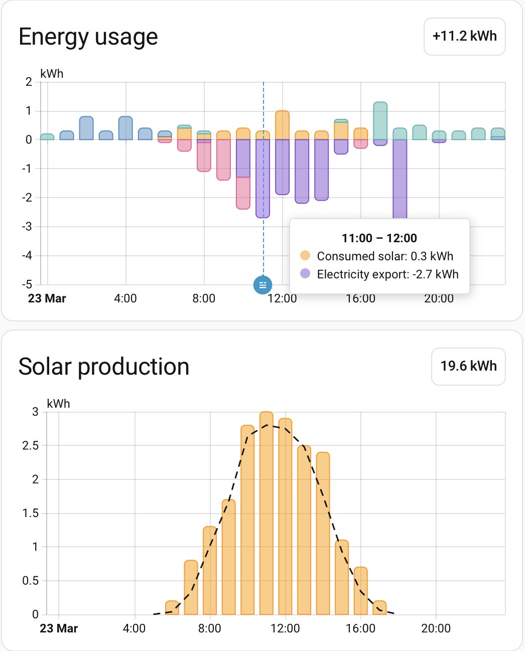

So I was looking at my energy graph yesterday to determine how much energy was exported to the grid and where it was sourced from and realised that HA doesn’t track this. Is this my configuration or a limitation of the system?
First graph shows export at 11-12 which you can assume is from solar but it could also come from the battery.

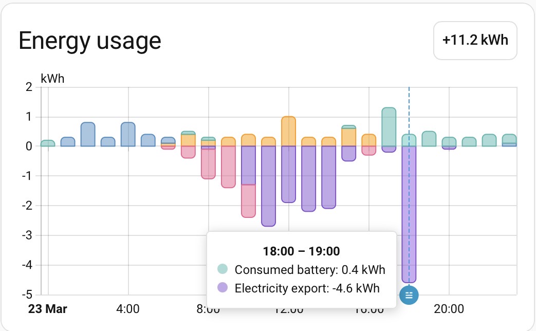

For instance at 18-19 the export is from the battery but there is no indication of this, there could be an element of solar.
So is it possible to configure to track the source of the exported energy.
I have a Tesla Powerwall using the default integration and a Solis solar inverter but the solar generation is measured by the PW and is used in the energy dashboard.
No, it’s not possible to explicitly define the source of exported energy.
