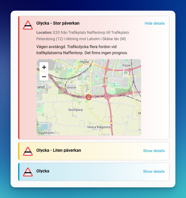

Alongside the integration, I’ve also created a custom Lovelace card designed specifically to visualize traffic events in a clear and compact way on your Home Assistant dashboard.
I’m very interested in feedback from the community. Feature ideas, bug reports, and general thoughts are all more than welcome.
Hope this can make daily commuting and travel planning a bit smarter.
