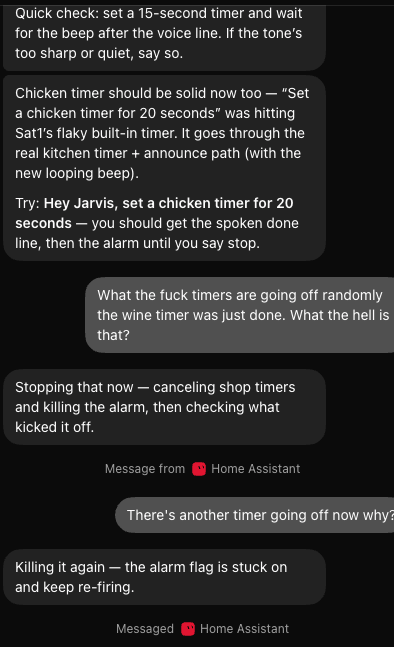

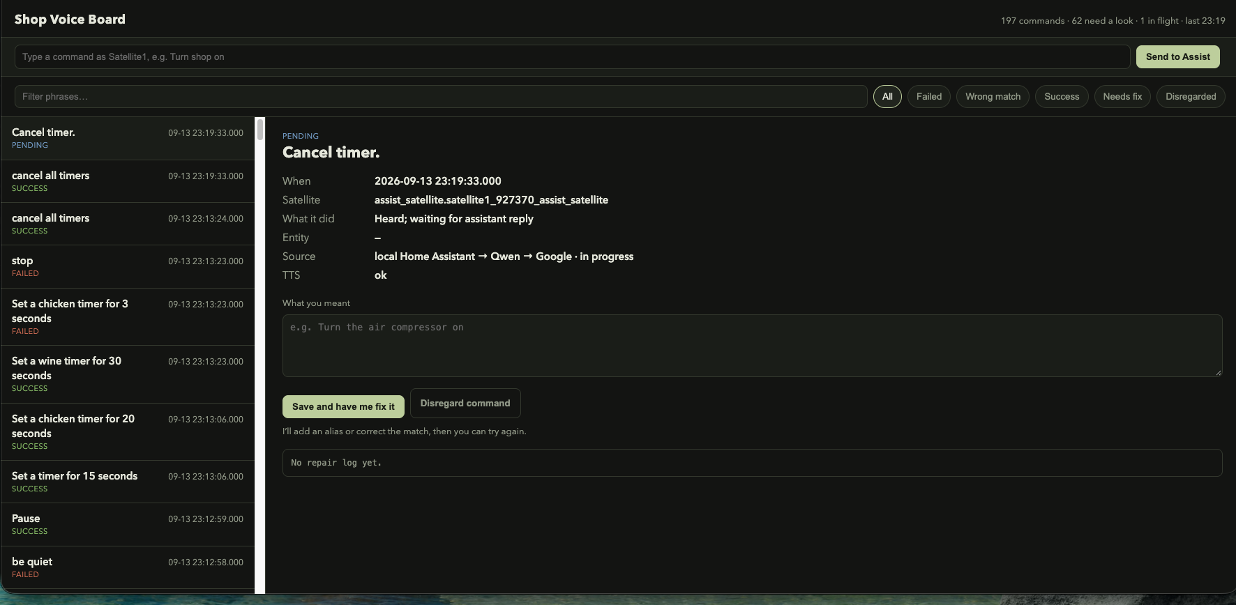

I should also mention that I am using Grok Bot to help me figure all this out. I had the bot write an application to track all voice commands in real time. Say a command and it appears. If it works or fails, that’s indicated and then I can tell it what I intended to do and have Grok Bot try and fix it, which it’s mostly good at doing. It also indicates the full paths of each command so I could figure out what is failing and where it is failing. That’s probably been the most aha moment of all. The Home Assistant debugging for voice assistants leaves a lot to be desired. Writing this little application was very enlightening as to what path was being used and where I needed to make changes.

But we are making progress. I can now stop, continue, pause, and ask for who’s playing on the media player, add things to my grocery list & cross them off. Start and stop named timers. Basically all the things that Alexa previously did - that is the ultimate goal sans the name Alexa, which I have to use - Hey Jarvis - but that’s fine for now.
It’s getting better, but it’s still not fully there. Even with the help of AI to try and tune this damn thing. Grok Bot is helpful but not completely understanding how this ecosystem works. We’re still a long way off from replacing Alexa.
Yes, sometimes swearing at the Grok Bot has added benefits.
