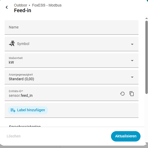

I have the Fox ESS integration and uni-meter running on HA. I’m currently trying to use the sensor values from the Fox ESS integration for uni-meter. The direct linking of the sensors didn’t work, so I also tried it with a helper — but without success. Unfortunately, I’m completely stuck. Who can help?

  energy-consumption-sensor = "sensor.grid_consumption"
  energy-production-sensor = "sensor.feed_in"

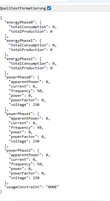

You can now open the Uni.Meter page, but it looks like Uni-Meter isn’t receiving any data.
