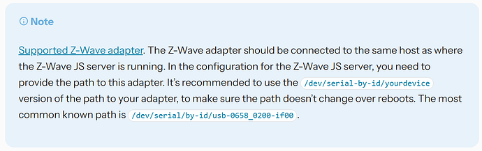

Since you switched back to the SD card, you might as well check whether this is a serial port issue as @fireplex mentioned above before attempting a restore:
  • Go to Settings > System > Hardware > All Hardware and take note of both the short device address (eg. /dev/ttyUSB0) and the longer serial by id address (eg. /dev/serial/by-id/usb-your_device_manufacturer_and_serial-if01-port0)
  • Confirm whether your Z-Wave integration is using the device address or the serial by id address. I don’t use Z-Wave so can’t help with that but it’ll probably be listed in your backup or if you download diagnostics.
  • Switch to the SSD, do a full reboot of HA and repeat the first step. If the short device address changed, that’s your issue - you need to change the Z-Wave settings to use the serial by id path:
