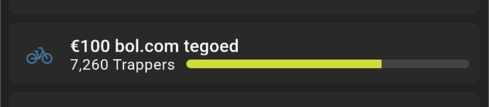

In my case I use it for a progress bar that tracks towards a certain goal:
