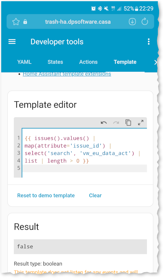

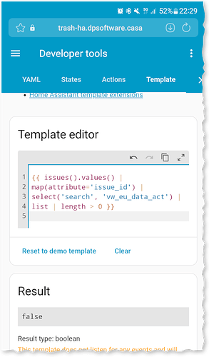

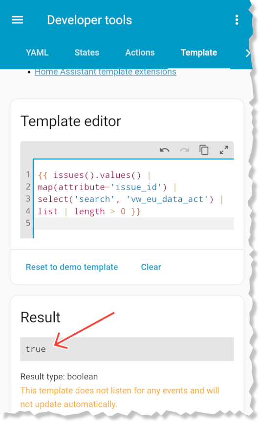

However, if I paste the template {{ issues().values() | map(attribute='issue_id') | select('search','vw_eu_data_act') | list | length > 0 }} into the template editor, it correctly prints true or false depending on the presence of the repair.

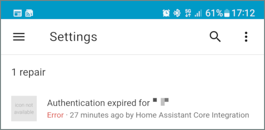

Yes, of course. But the problem is that I have “repaired” the integration and it breaks every couple of weeks, while the automation doesn’t trigger (and thus doesn’t generate a flow to examine).

I think the problem may stem from the fact that your template doesn’t reference any states or use now(), so it only updates on restart or reload… this kind of thing is obscured bu the template editor, because it re-renders every minute on its own.
