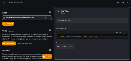

You can set the threshold value in the numeric state trigger to 49.9 or you can use a template trigger.

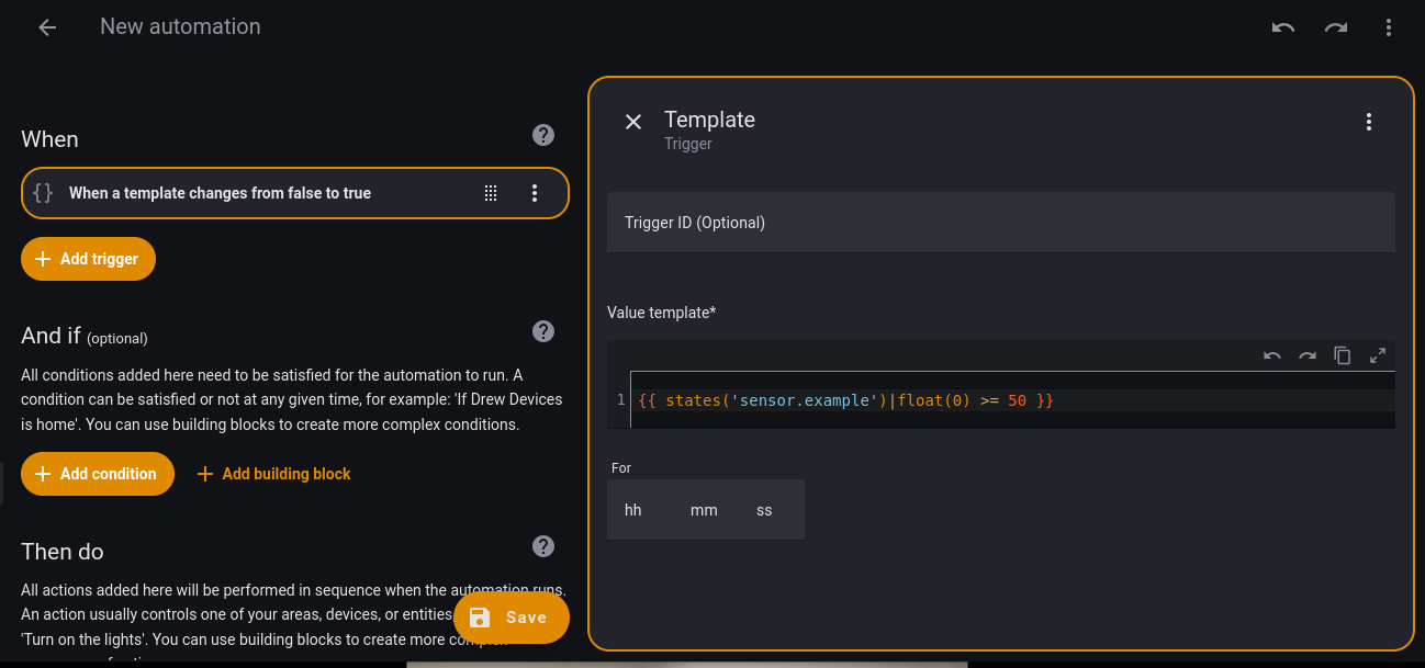

That depends on how you define GUI…
Template triggers can be set up in the Automation Editor, does that count or not?
