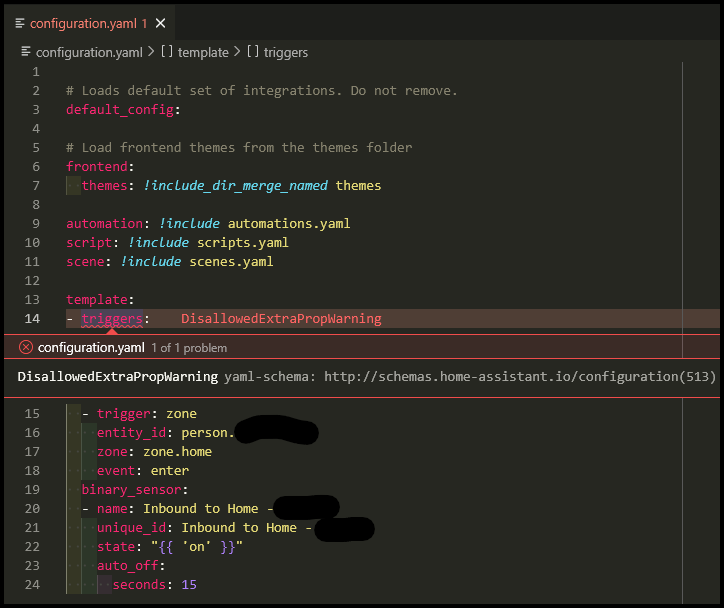

I’m getting this error when adding to configuration.yaml. I don’t see “triggers” anywhere else.
Those warnings aren’t real, the syntax checking extension is significantly out of date.

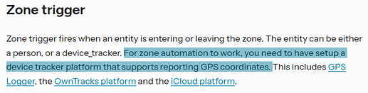

Zone triggers don’t work that way, they require GPS coordinates of the device_tracker to change… that’s why only GPS-based trackers can be used with them:
You can’t use set state to simulate a zone trigger.
