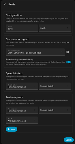

I have the Home Assistant Voice PE and it’s setup to use the “hey Jarvis” wake word. In my Settings/Assistants menu I have an assist named “Jarvis” that is set as the preferred assistant. It’s Conversation agent is configured to use an Ollama LLM model (gpt-oss:120b-cloud). Speech-to-text and Text-to-speech are both configured to use Home Assistant Cloud.
Currently, if I do this now, Jarvis just thinks I’m having a conversation with him and thinks I’m being weird and responds like any other LLM would. But If I open a conversation from a dashboard using the assist button and type the sentence “trust no one”, then it triggers the automation appropreiately and Jarvis responds with the message in my automation. Do I need to change how the speech-to-text is configured?
