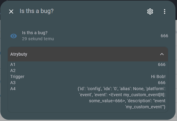

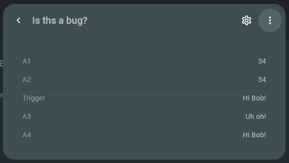

  1. reload templates, the sensor will have no state and no attributes, as expected:
  1. send an event my_custom_event with data field some_value: 34
Results:
  1. attribute a1 shows the value from trigger.event.data.some_value - OK
  2. attribute a2 references a1 as if it was a variable, and gets the new value - WEIRD
  3. attribute trigger has a static text - OK
  4. attribute a3 tries to reference trigger variable (like a1 before) but that variable is now hidden by the attribute named trigger - SUPER WEIRD
  5. attribute a4 confirms the new value associated with “trigger”

But an attribute is not a variable! :slight_smile: And now I have proof that wasn’t always the case: the same sensor in core version 2025.4.4 produced this result:

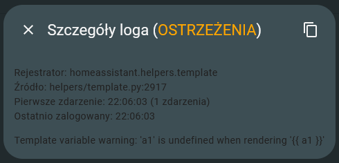

and a warning in the logs:
Template variable warning: 'a1' is undefined when rendering '{{ a1 }}'
