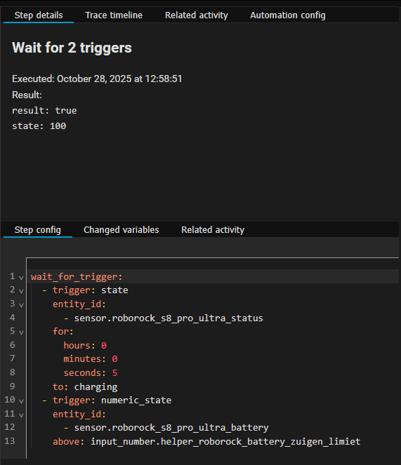

I created an automation to start my robot vacuum when it has the state “Charging” for 5 min and the battery is more than 60% (which is stored in an input number helper).
Even though both triggers are true, the automation does not continue with the next action and seems to be waiting for something.
See screenshots:
Already lowered the time to 5 seconds, easier for testing :wink:
Also used a fixed number in stead of the helper, no difference.
Disabled the triggers one by one to hopefully find out which one causes the issue and it happens with either trigger enabled. But when I disable both, the automation continues.
Not sure what is happening here.

That is absolutely the case. Both trigger-values were already “reached” before the automation ran.
