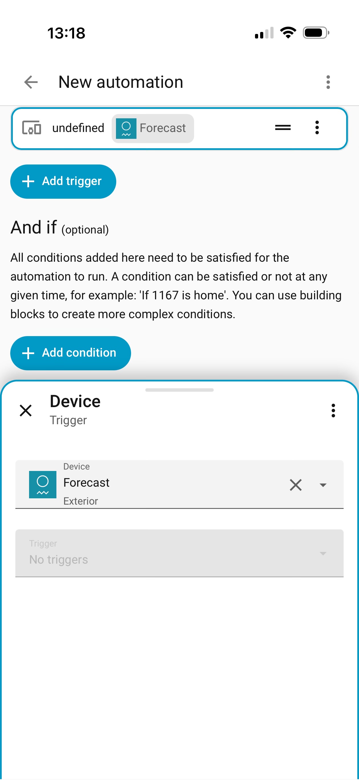

Hi all,
I have done the Mitsubishi heat pump hack as seen here
I’m trying to have the modes of my 6 splits based off the outside weather
I can select the weather as a device but I don’t get any triggers for it?
Ideally if the weather is going to be cold I want the heat pumps in heat mode, hot cool mode, and if the weather is going to be in a comfort range to just turn the system off
Any tips?
Thanks,
Jay
Grock tried to help, but I just get errors

What’s the logic on not using triggers?
I don't know what you are referencing here....?
Avoid Device Triggers
For the specific instance of what you shared in the original post... Because the Met.No integration does not provide any usable triggers as a "device". The general reasons to avoid Device components are covered, in detail, in the post I linked to.
