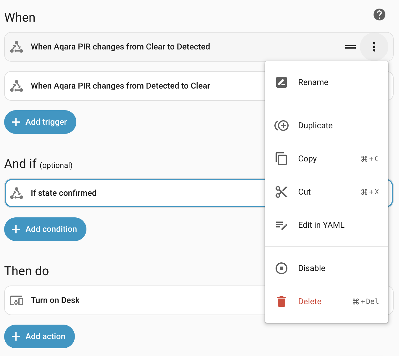

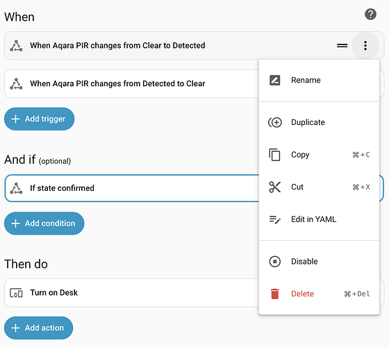

I am making a basic automation for a PIR to trigger a light and want to use two triggers (with their own Trigger IDs) to either switch on or off a light.
I made the automation from scratch. After adding two state triggers and clicking the three dots, the option for Trigger ID is not displayed…
Any ideas what I’m doing wrong?

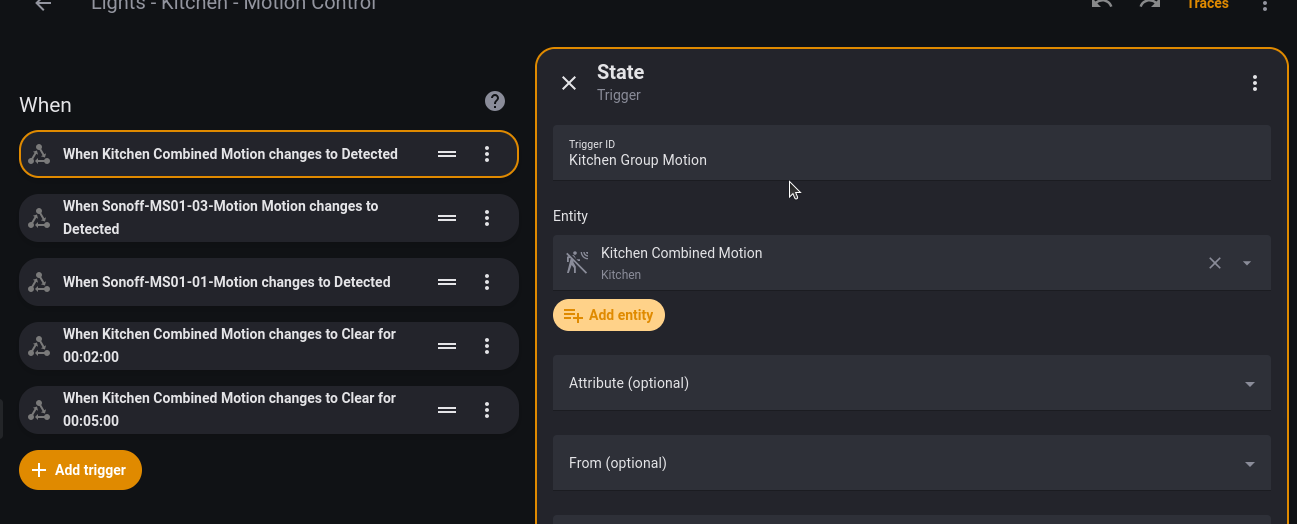

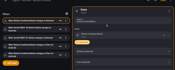

For triggers that have a defined ID, it was moved out of the breadcrumbs menu to the top of the main trigger popup:

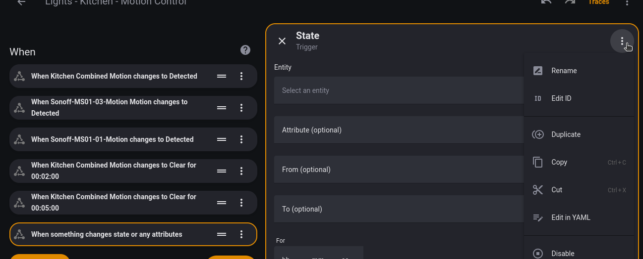

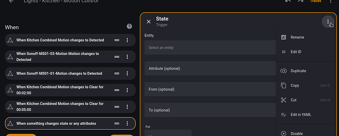

For those without a defined ID, you’ll find “Edit ID” in the breadcrumb menu of the trigger popup
Thanks so much for you exteremly rapid response.
Found it!
