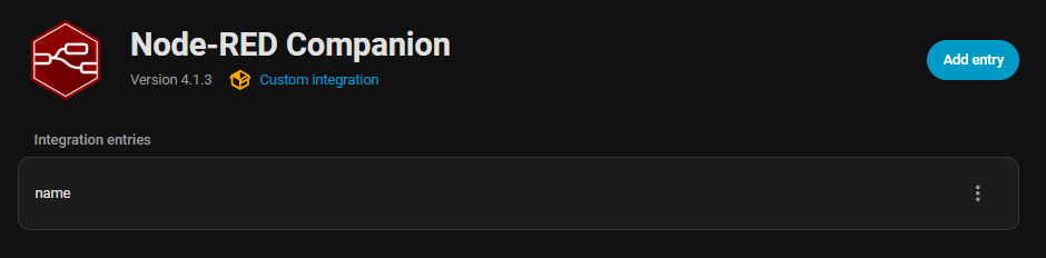

I have the companion integration in Home Assistant, but its completely empty.
From what I could gather, I have to somehow expose these flows to Home Assistant, and then use the buttons in Home Assistant to trigger them?

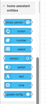

In Node-RED, use a Button node. Create one for each action you want to perform in Home Assistant, then connect its output to the input of an action node.
This will create a button.xyz entity in Home Assistant that you can trigger with the button.press service—either from the Home Assistant dashboard or through an automation—to run the linked flow in Node-RED.

I can’t believe it was as simple as adding a button.
Thank you.
