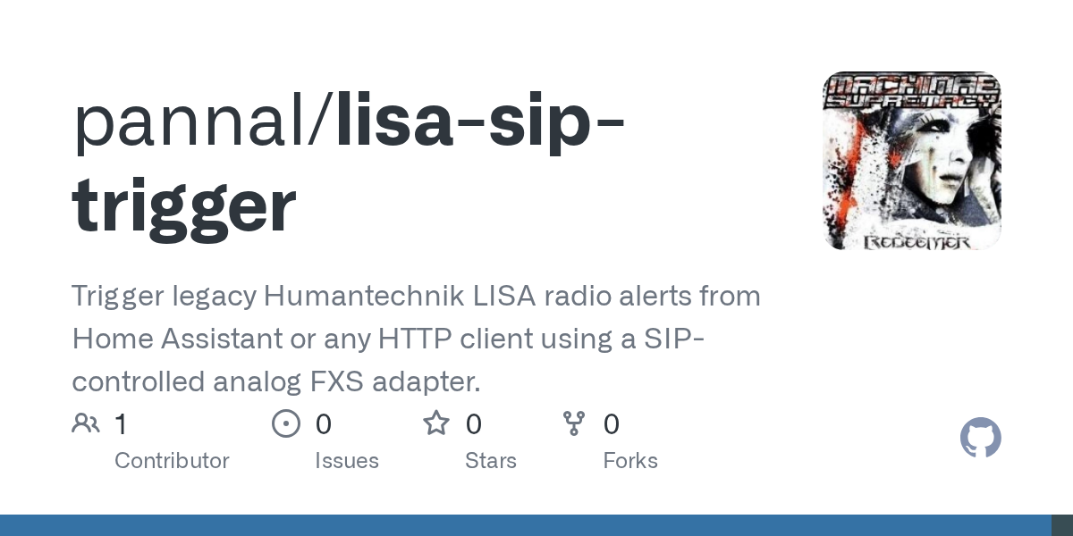

I ended up writing a small Python service for it and put it here:
There’s also a prebuilt Docker image:
The HTTP API is deliberately tiny:
POST /alarm/start
POST /alarm/stop
GET  /status
GET  /health
/alarm/start triggers LISA immediately and keeps retriggering it while the alarm
is active.
/alarm/stop cancels any active SIP ringing attempt and prevents further
retriggering.
