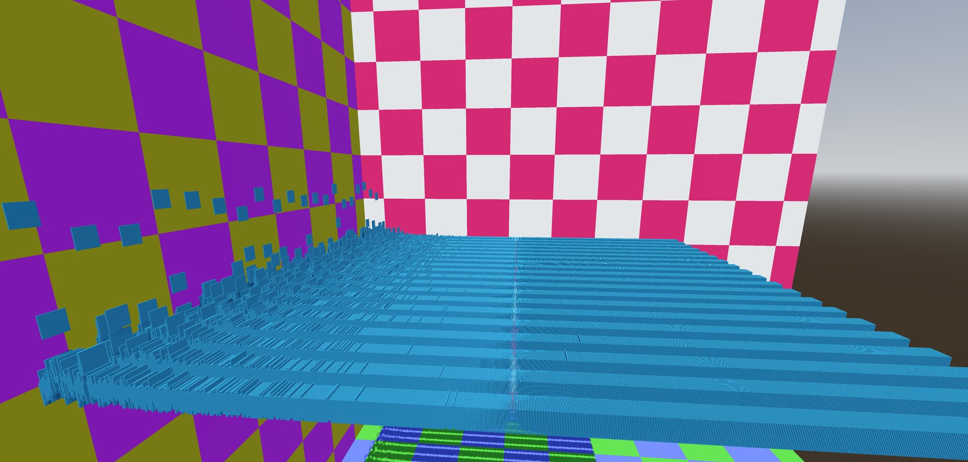

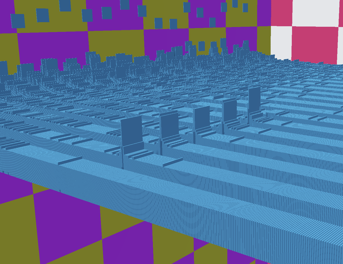

This is a frequency waterfall for a fairly quiet room:

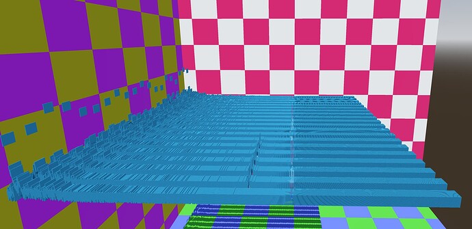

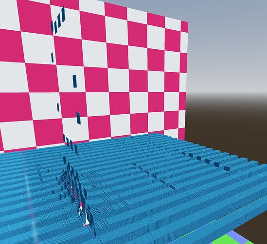

If I turn on the the AC, I start to see noise on the low end of the frequency range:

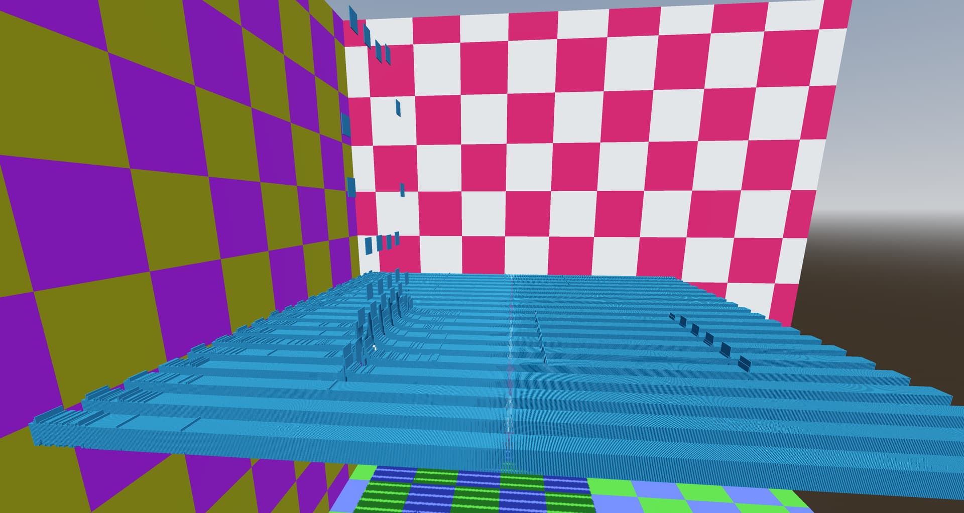

However loud beeps really stand out:
I think the small ridges are either an artifact of the FFT or they may be harmonics.

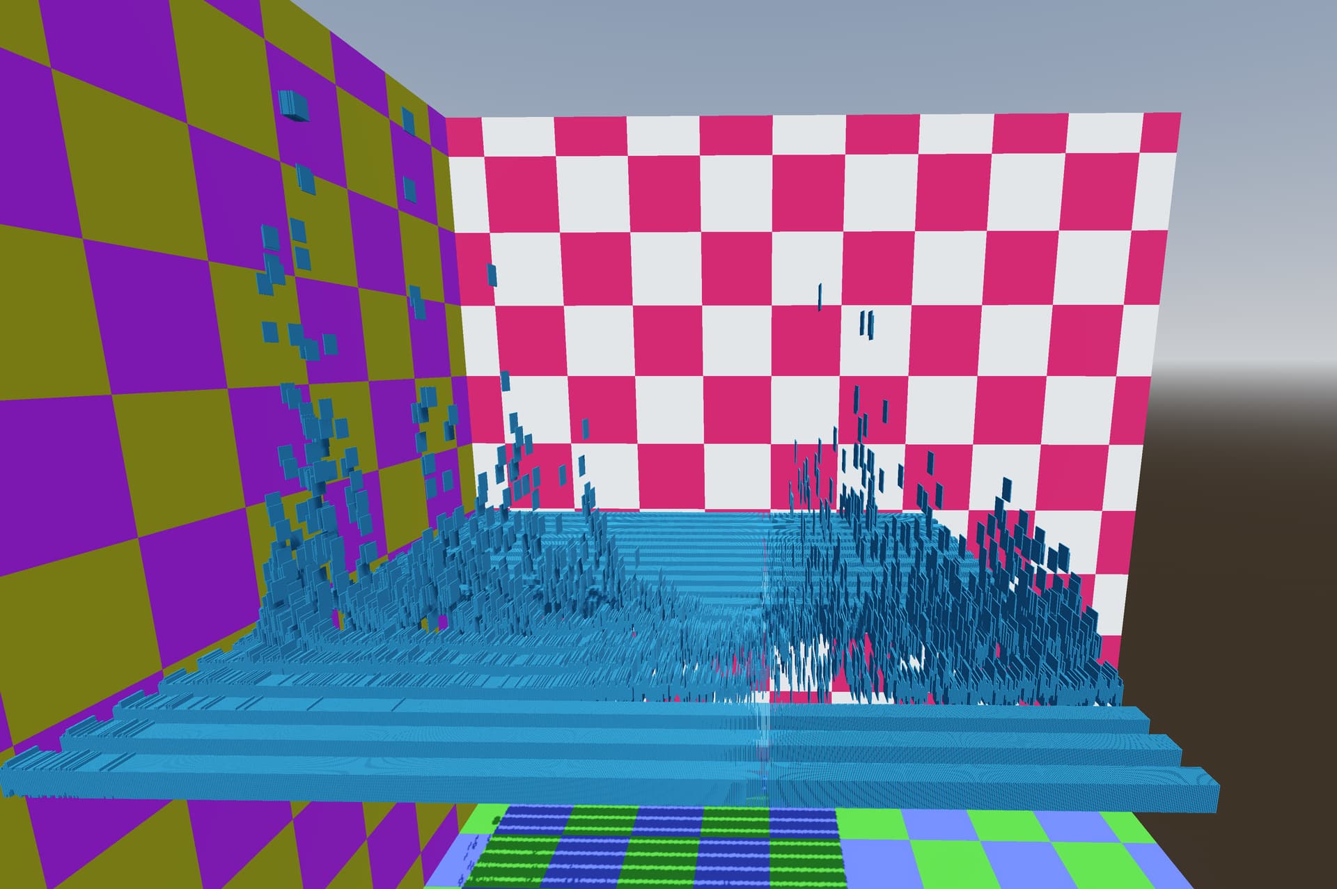

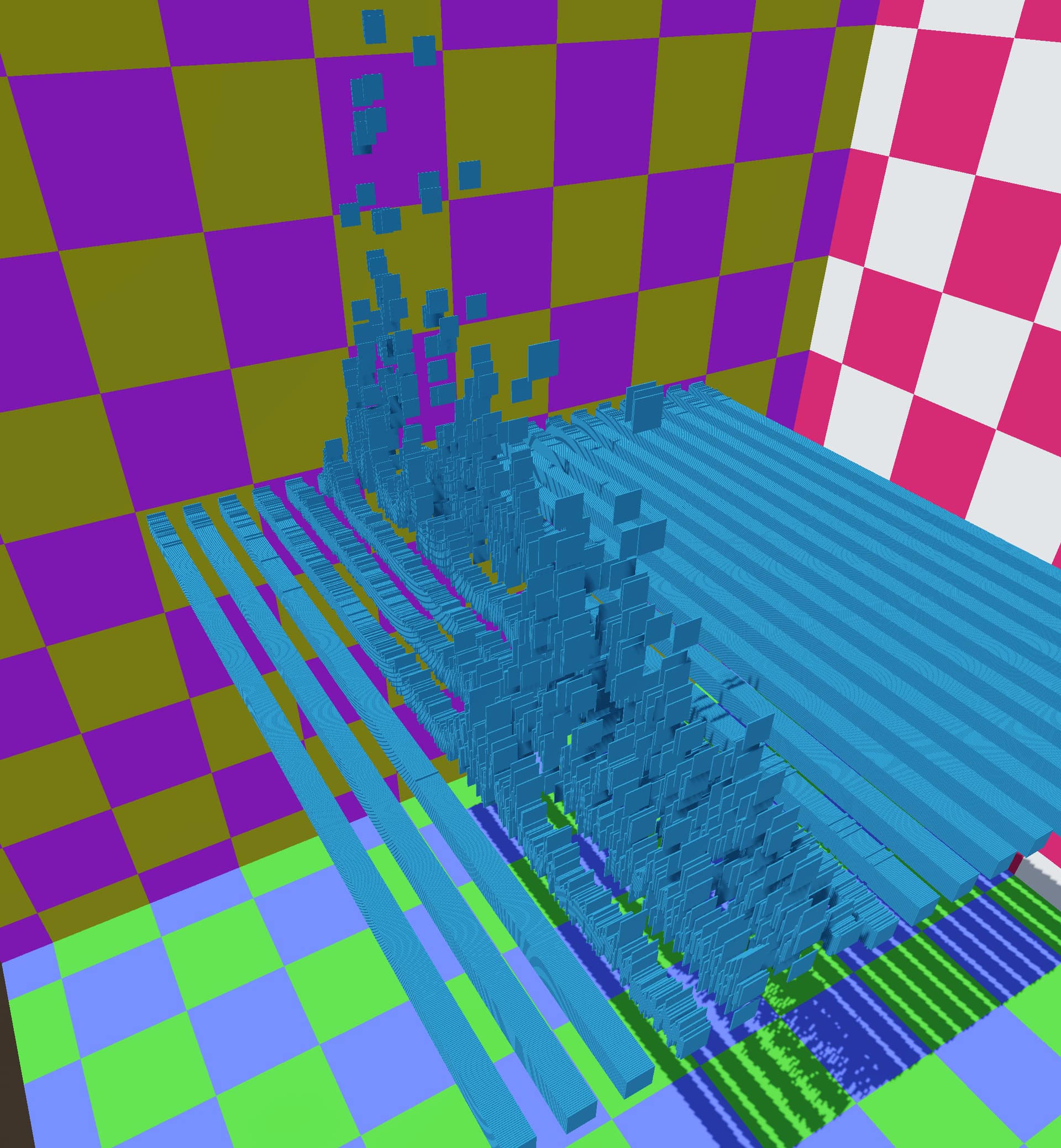

The problem is other loud noises like speech absolutely swamp the frequency range:

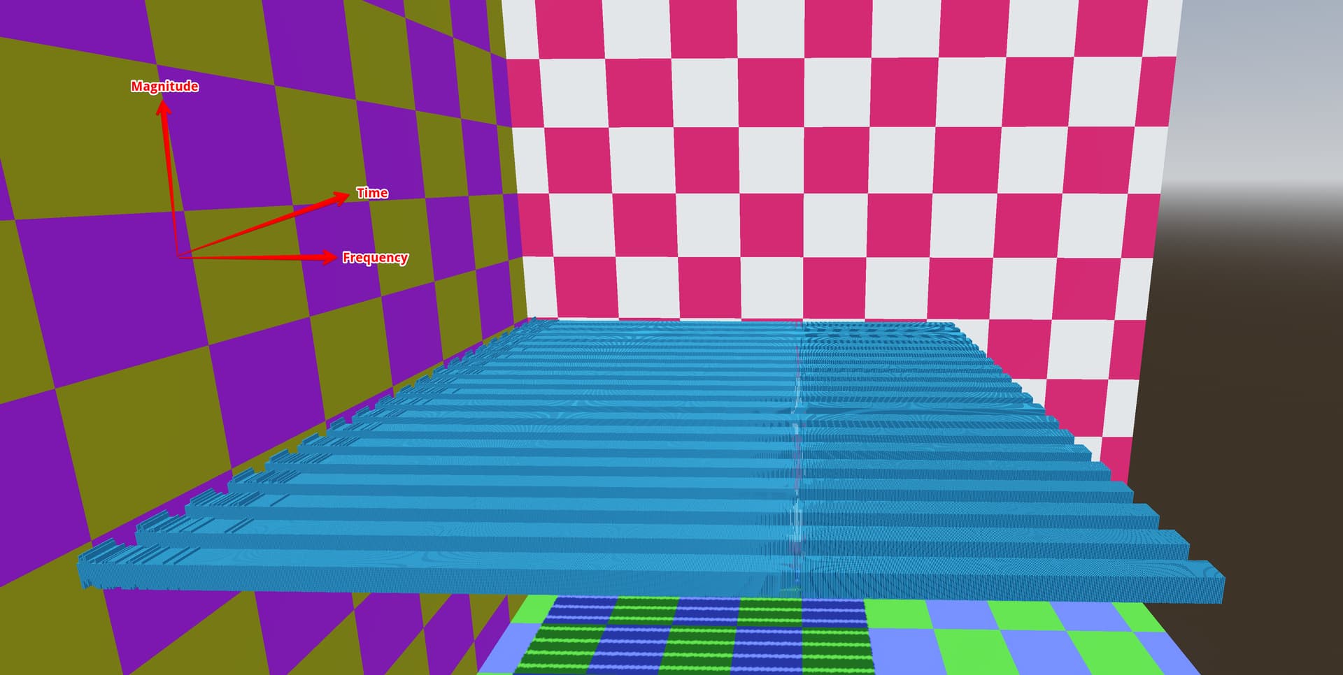

When I get a quiet beep it’s still possible to see it in a quiet room (even with the AC running)

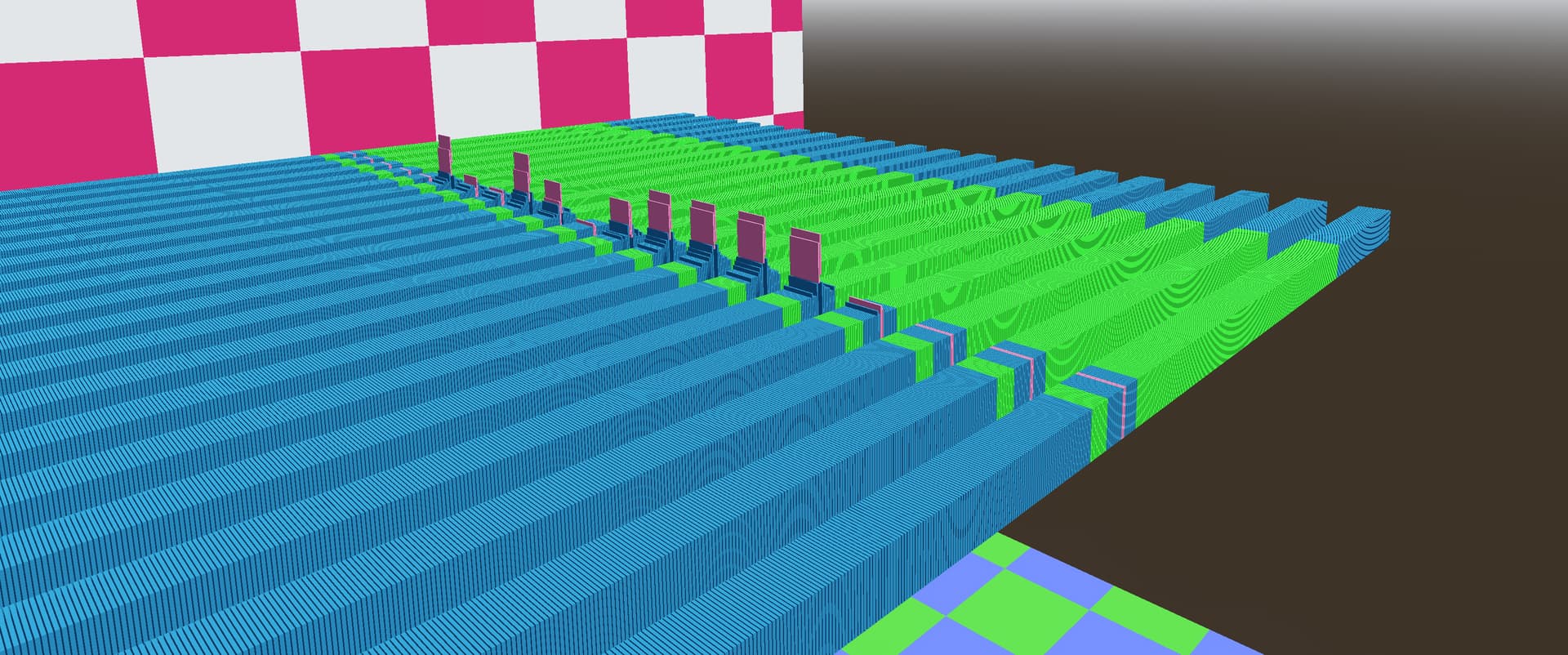

Visually the detection bands look like this:
The pink band is the detection band.
The two green bands are the low (left) and high (right) bands.
Since the higher frequencies are normally much quieter than the lower frequencies I use a much wider band on that.
Note: I leave a gap either side of the detection band as there can be noise close to the target frequency.
