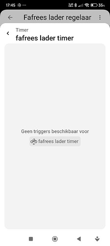

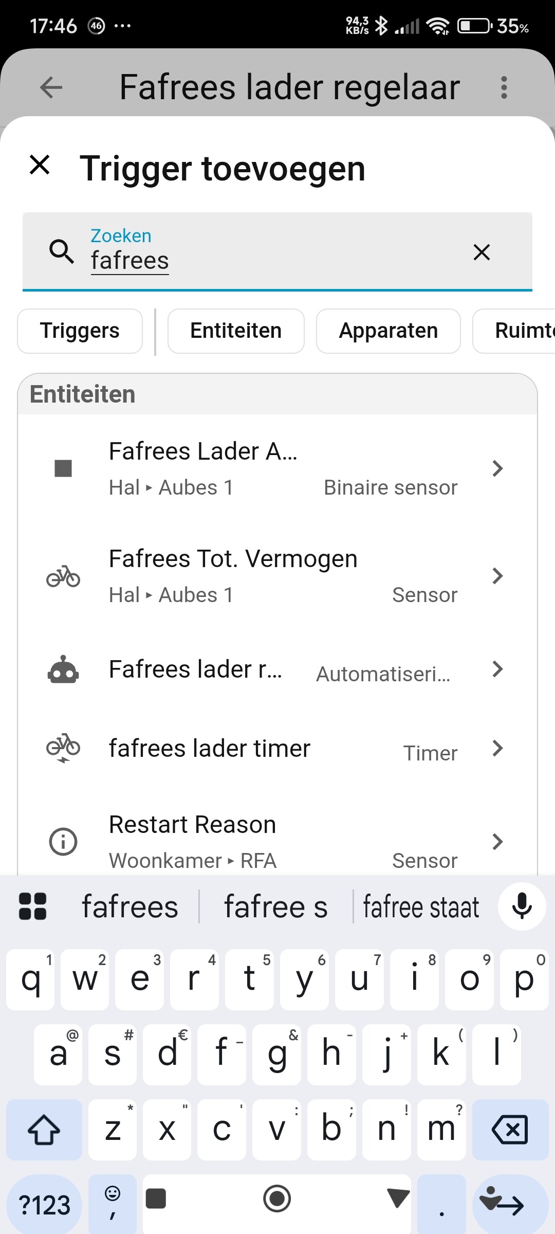

I want to adjust some automation of a charger. After adding a timer(helper) and starting it even…
I want to add a trigger for when the timer ends. However I cannot add any trigger with that timer as there ’ are no triggers available ’ for that timer.

So I can no longer select a timer and the property ‘inactive’ to act as a trigger.

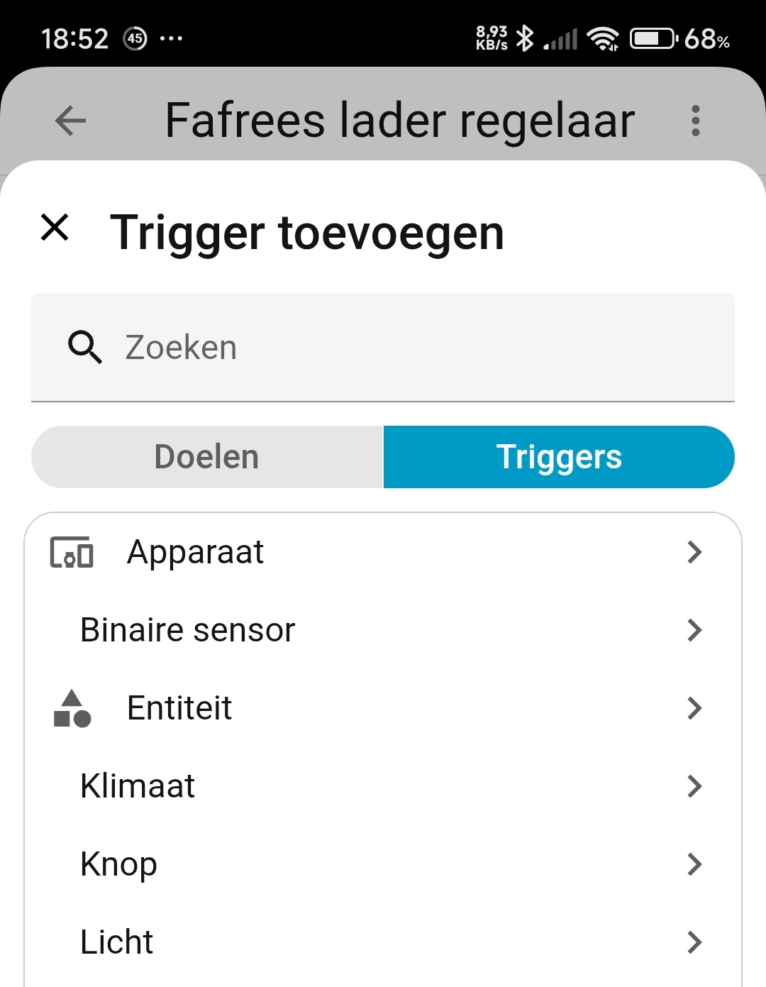

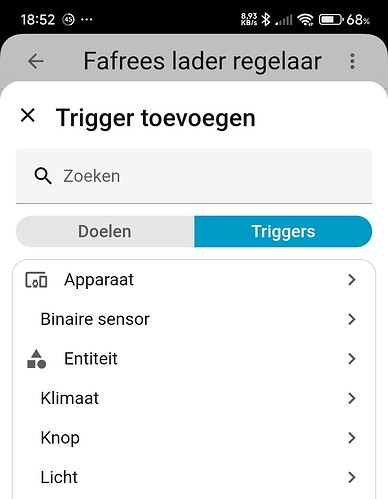

After selecting ‘new trigger’, select ’ Entity’ instead of searching for a timer.
It looks like you are using the experimental, purpose-specific triggers feature from Labs. There aren’t any purpose specific triggers for timers yet, so your search results are correct. Based on comments from the team working on this feature, there are around 200 triggers that they still need to develop and add before all the core integration triggers are covered, then there are a currently-unknown number of purpose-specific triggers that custom integration may add over time.
So, currently, just use either a State trigger or an Event trigger for your timer entity… if you just search for “state” you should get:
If you want a trigger that is specific for the timer finishing, you will need to use an Event trigger, as described in the Timer integration docs.
