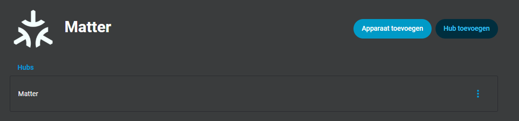

  • OpenThread Border Router integration in HA:
  • Thread integration in HA:
  • Matter integration in HA:

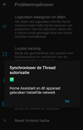

  • Thread credentials synced in the HA Companion app (step 3 at Thread - Home Assistant). 'Home Assistant and this device are using the same network '.

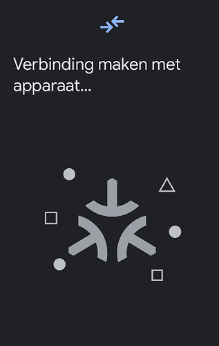

    Connection with device…:
  1. Connected, generation Matter credentials:

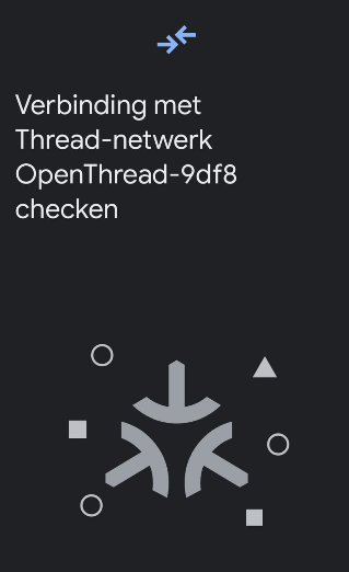

  1. But stuck on ‘Checking connection with Thread network’, and an error after waiting a few minutes.

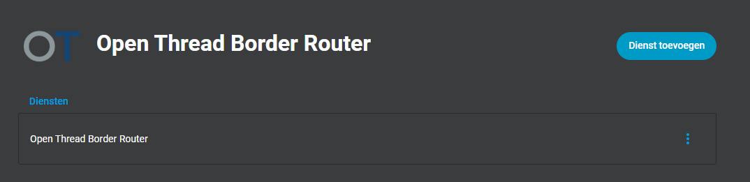

One of the differences between this container and the openthread/border-router I used before is that with Package hass-otbr-docker · GitHub I can access the OTBR web interface (and change the port using the OTBR_WEB_PORT environment variable). I now doubt whether openthread/border-router even has a web interface at all, but in any case I cannot reach it on the (apparently) default port 80. I also could not find an environment variable to change this.

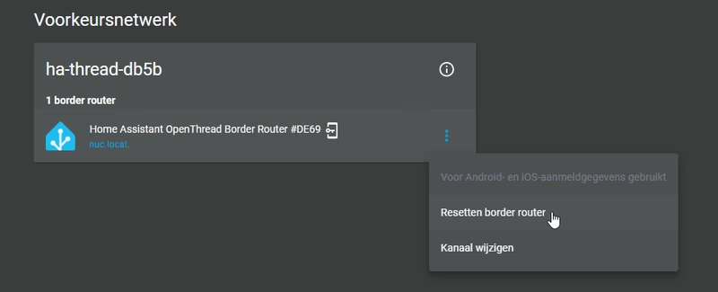

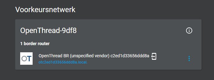

Another thing I noticed is that the HA app sometimes searched for the wrong Thread network, despite the successful synchronization of the Thread credentials or the message that HA and “this” device (the phone with the HA app) are already using the same Thread network. Still, after adding a Matter device, the HA app would search for a different Thread network than the preferred network in HA. With access to the OTBR web interface, everything becomes much clearer.
Possibly related to the above, but I noticed that sometimes the name of the Thread network was changed. Apparently, HA has the permissions to do this, and it does not only happen when you choose “Reset Border Router.”
