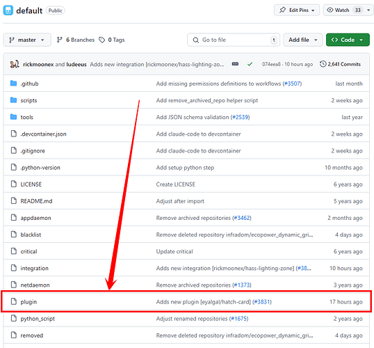

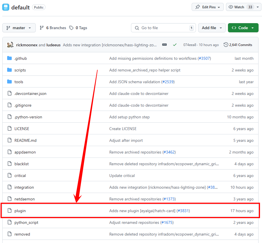

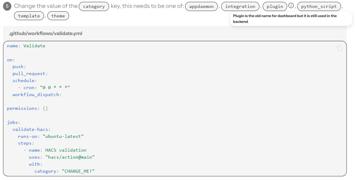

There is no “plugin”.
HACS only supports
  • Dashboard resources
  • Integrations
  • Templates
  • Themes
From page GitHub Action - HACS
From HACS official GitHub repository:
That’s a dashboard resource. Interesting, I was not aware it was called that in the HACS backend.

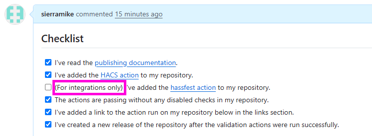

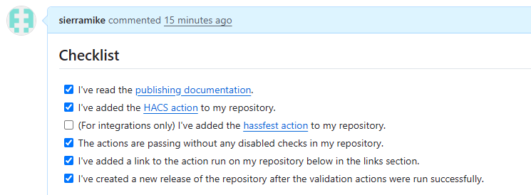

Okay, I’m answering to myself because I finally found the issue, it may help someone else in the future.
When submitting the PR, there is a checklist that should be all checked. BUT, it doesn’t say we sould NOT check the “hassfest action” line if we don’t add an integration.
I thought I should check EVERY box to ensure I have done everything and the hassfest line will be ignored for plugins.
In fact, it is not ignored, the box MUST NOT be checked, as per the below:
Whithout checking this one, the PR is not auto closed any more by hacss-bot.
Yes it does:
I’m afraid it’s not so clear, for what I understood “hassfest action link is not needed for non integrations” but I didn’t understand “don’t check the box”.
When opening the PR, there is a comment:
<!-- Do not open a pull request before you have completed all these, it will be closed. -->
So, I understood, “please ensure you have checked all items”.
Well, I found the problem and finaly managed to work this out, but if ever someone else may fall into the same misunderstanding, I hope he will find this post to clear everything out.
I hope this is it, will try the PR for the 10th time… And no, it is not clear like this
