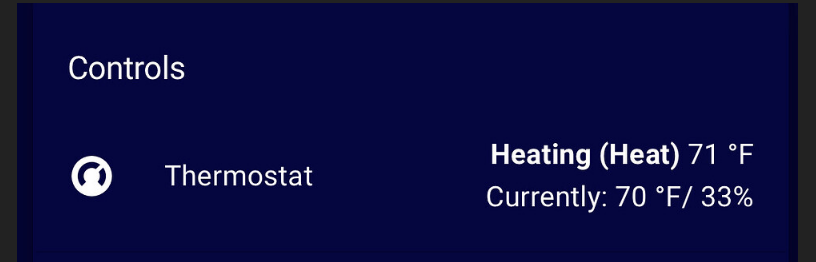

Hi there, sorry should’ve specified in the HA dashboard. Here’s a screenshot of what the device control and sensors are showing:

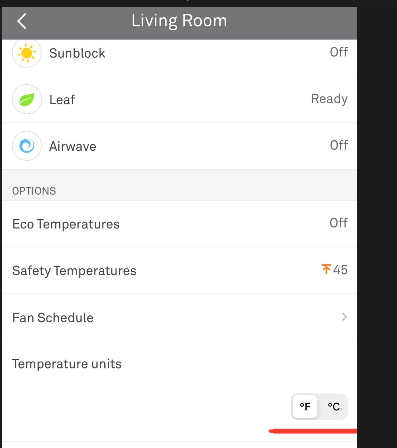

My bad, missed that…This indicates the native app is set to °F
The app setting doesn’t affect HA from switching from °F to °C.

I have the Nest App set to °F and HA set to °C. In my opinion, the issue is on the HA side. I’d double check the sensor setting to see if the original change from °F to °C took.

So the senator is showing correctly in C but the control card cannot be set to anything other than F.
Here are both entities in their respective card types on the same dashboard:
I eventually want to get the control at the top to show the same as the sensors below it
