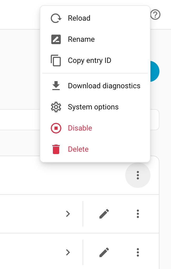

Probably a stupid question, but how do I delete the failed Z-Wave JS integration? I can’t do anything to JS in Entities or Devices.
(Yes, I’m a new Home Assistant user.)
You do it through the integrations tab. Click the integration, then the three dots:
Thank you very much for the assist!!!
I have it up and running now. I couldn’t delete JS Integration, but I was able to disable it IOT add Z-Wave. Now I can start adding Z-Wave and Zigbee devices to Home Assistant.
