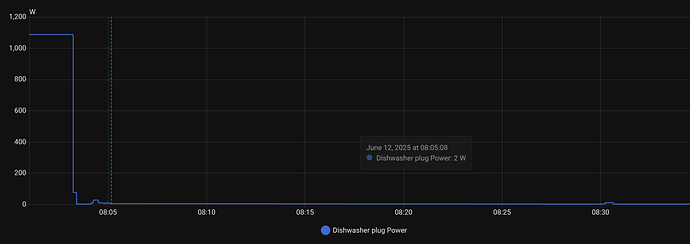

I am using a smart plug to monitor power to my dumb dishwasher and want to receive a notification when the wash cycle is complete, as close as possible, to the time it actually finished.
I was going to use the logic, “If the power is < 2.6 watts for three minutes” and “dishwasher_running (boolean helper set by another automation) == ON”, then assume the cycle is finished and send me a notification.
The problem is that the cycle dips to 2w for 25 minutes (08:05:08 - 08:30:09), then jumps to 4-10w (when the washer is draining) before being done, where it sits at about 2w until I come by and press then OFF button.
What is the best way handle this pattern?

Maybe you could use this as your trigger?
triggers:
  - trigger: numeric_state
    entity_id:
      - sensor.dishwasher
    above: 3
    below: 11
    for:
      minutes: 3
Perhaps you need a longer for time?
So when off it is 0?
0(off) >> 2w (on, cycle start) >> 4-10w(draining) >> 2w (done) >> 0w (manual off)
Would use multiple triggers and add states
Trigger 1 - from off to 2w
Condition - off xx minutes
Running
Trigger 2- from 2w to >3.7w
Draining
Trigger 3 - from > 3.7 to <2.3w
Complete
Trigger 4 - to <.5w
Off
You can use trigger ID to invoke specific action for each trigger and set state or send notifications
The washer is only at 0w when the power button is pressed, which turns off the 7-segment display.
If 25 minutes is the avarage time after the mayor power drop you can base a automation on that
I think this is a good option. Possibly utilizing a “Select” helper with the states
Running
Draining
Complete
Off
The select state is advanced based on the power level and the state that is currently selected.
You can complicate it as much as you like, but as stated above, change this to 5 or 10 minutes because you will not even notice it in actual use and this should work for you…
What if, for instance, someone opens the door for a few minutes to fix a pot that flipped or to add another dish.
Give the “I’m done” one plenty of time.
