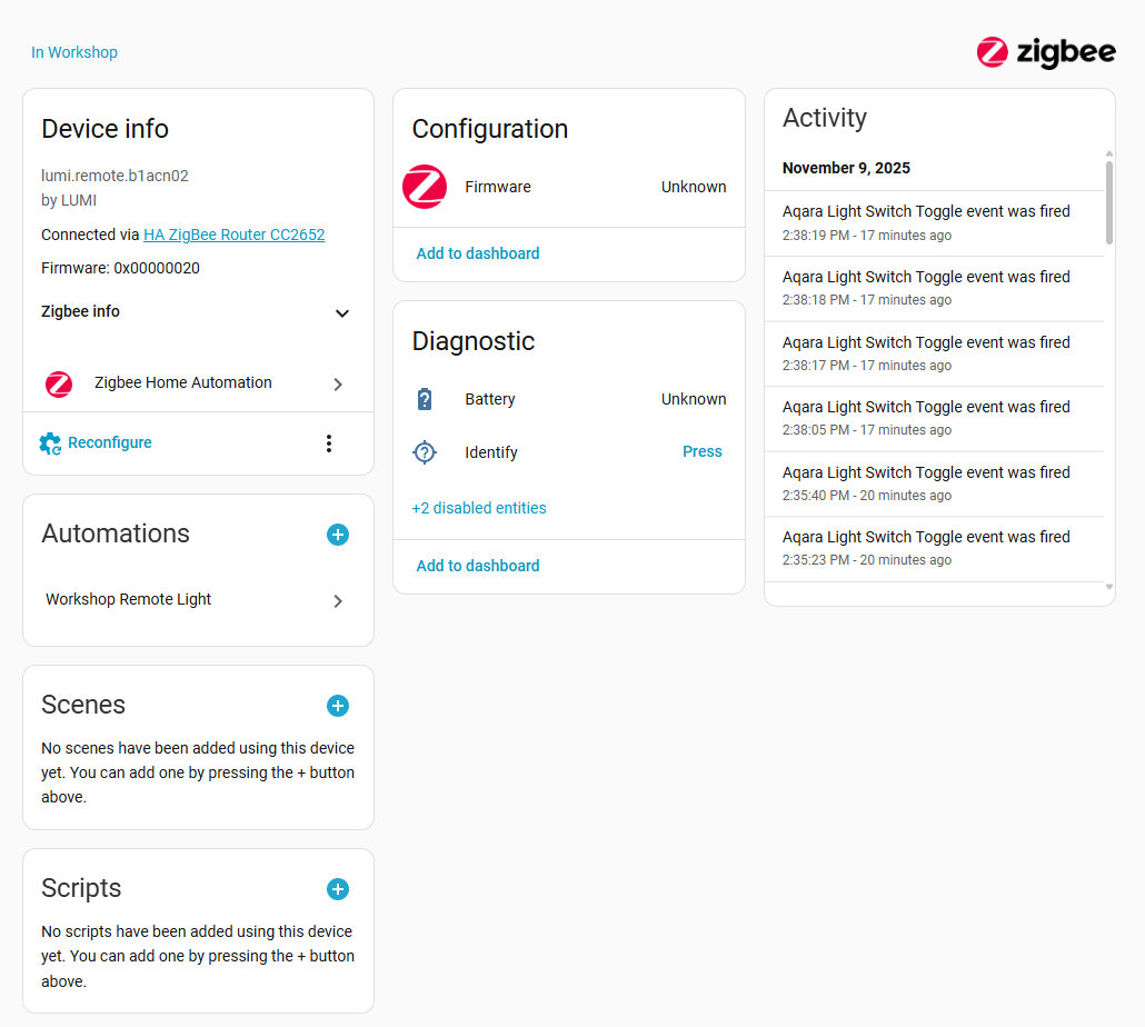

Getting back into HomeAssistant after a few years - New house → New HA setup. I am running ZHA and all devices seem to pair nicely.

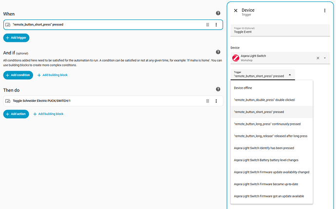

I have a simple automation to turn on a light relay, which should be triggered by a button press. Button is an Aqara Wireless Mini Switch T1 .
When I press the button a Toggle event is fired in the activity log:
But in the Automation I cannot select “Toggle” as the trigger - only short press or long press and none of these work as trigger:
I am not sure if this is configuration issue or I simply messed up.
I was running zigbee2mqtt earlier and perhaps I should just switch back to that?
Hoping someone can help - This is pretty simple and should work

If the Device trigger isn’t working, you can always use an Event trigger . You can get the details of the events the button posts to the event bus by using the Events tool . You will need to set it to listen for zha_event in the " Listen to events" field.

Sure - Here is the yaml for the Automation:
alias: Workshop Remote Light
description: ""
triggers:
- device_id: 2c1622a3601edddbfbbed92ceee56b69
domain: zha
type: remote_button_short_press
subtype: remote_button_short_press
trigger: device
conditions: []
actions:
- type: toggle
device_id: d3224c52612382a707e0fde86bef71d3
entity_id: 9aa4e7b5ef695b618172e22547815954
domain: light
mode: single
mahodk
