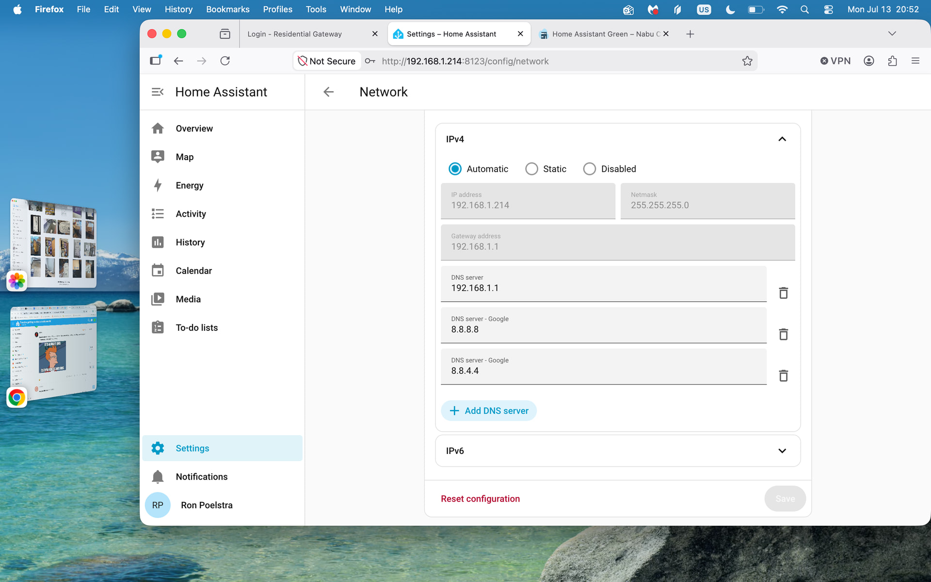

Sounds potentially like a DNS problem with local network but not internet. What does it look like in Home assistant settings/network?
Are you able to ping 1.1.1.1 ?
Yes, I can ping 1.1.1,1

A Nabu Casa account or other external services are not required for the updates you need, but my inquires tells me nothing is connected outside your local network.
The Calix gateway is the next place to check. Conexon uses MyConnectHome management from what I remember. Is it actively blocking your HA device?
Posting HA system logs may provide more insight.
You should set a static address for your HA device. When you reboot the system you may lose the current IP address and other devices may not be able to find it.
Have you disabled IPv_6. I’ve heard that some routers will use IPv_6 in preference to IPv_4 and not send your requests to the DNS. Reboot the system if you make the change.
Thank you so much for the info. I will disable IPV6 and reboot, hopefully I will not need to call Conexon!!??
