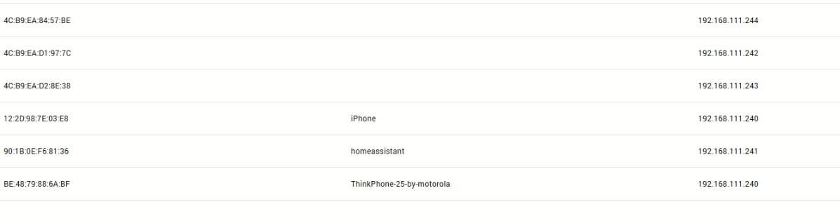

But I can't figure out what the issue is. As for mDNS forwarding, the network is flat and some other mDNS services are working fine. Looking in the discovered devices via DNS, I can see the IP addresses of my Roombas (DHCP won't change due to DHCP reservation...)
