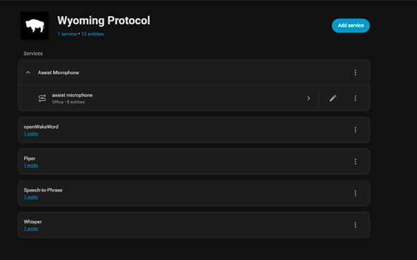

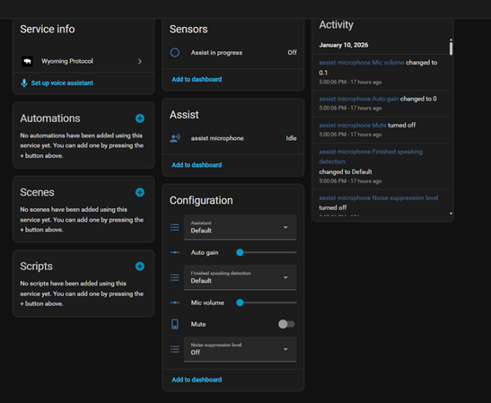

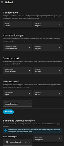

Got the same problem. Not being a developer, I used copilot to try to help me out. It seems we need to install Wyoming Satellite. But there is no way to do this via the interface and it seems to be deprecated. The new way to do it seems to be GitHub - OHF-Voice/linux-voice-assistant: Voice satellite for Home Assistant using the ESPHome protocol. But that’s not ready yet. So I’m quite frustrated, just bought the mic and the speaker expecting it to work easily. But sadly all is in flux now…
In the end I ended up getting it to work, but had a hell of a time :slight_smile:
TBH I think I uninstalled all the Voice Assistant configs, Wyoming, OpenWake Word, Piper etc. Rebooted the Raspberry Pi, then added them all back as if doing it for the first time.
I started a write up that may help, but based on the back and forth and voodoo performed I may have missed some stuff.
I haven’t made a final version / checked the logic as it was more of a data dump as I was going. But use what you will.
Reminder… This was for my setup (running a custom Voice) of a Raspberry Pi 5 running HAOS, with a USB microphone and USB Audio Output device attached.

Troubleshooting:
The default voice is still being user
Open the Piper add-on Settings
Under Configuration ensure the Voice is set to en-US-lessac-medium
ensure the Update voices switch is OFF.
Restart all wyoming add-ons (or reboot, probably quicker)
