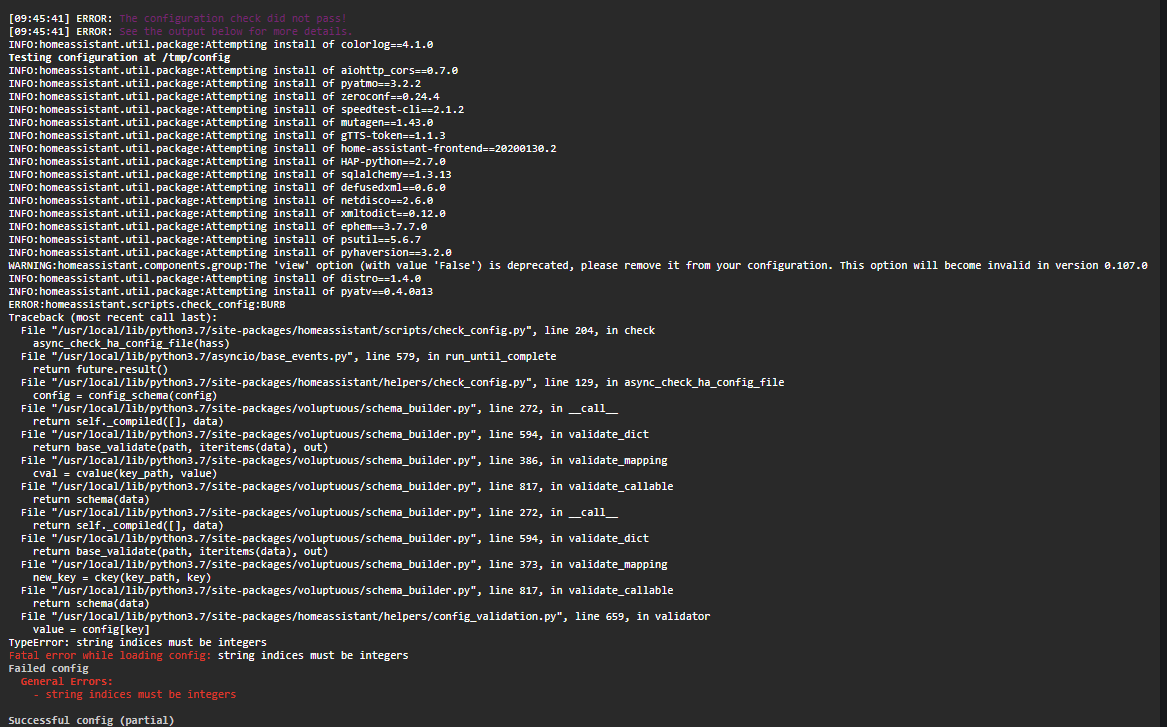

I can’t update my system to 0.105.3. I got these error in the log file
Can someone help me? I don’t know how I should fix this.

Are you using netatmo? I hit this when I hadn’t properly updated to the new config property names.
Yes - I’m using Netatmo Climate… But the entities are up-to-date and I’ve checked everywhere.
Should I try to comment all netatmo out, and check the configuration?
Maybe remove netamo and update and then add it back
I’m not sure if you followed the steps for the breaking changes, but the property names were changed. They are now client_id
and client_secret
. I found that having the old names gave the error you listed. It seems like a bug that this wasn’t handled more gracefully.
I removed Netatmo Climate, and it is working now!
