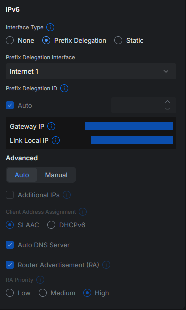

How is the IPv6 aspect of the router configuration, the one that new devices rely on to ‘phone home’ for once-off onboarding?
In the Router settings, it appears to be set as the following:
I’m not super familiar with IPv6, so I’m not exactly sure what I’m looking for here.
